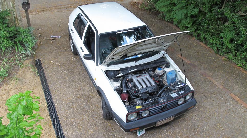

          Very easy, let a 19 year old ignore his fathers explicit request to measure the drive shafts, then google how tight a nut should be without any idea of 200 foot pounds of torque, then get a 4 foot bar and make a total mess of it all because dad didnt want an argument..
          That was just the beginning of a huge saga of CV issues that stemmed from the fact the original mechanic used the wrong CVs and son tried to use a MK3 assembly. So after 3 sets of CV, (switching back and forth from 90 to 100mm) which luckily I sourced locally, I got it right. Note, if doing CVs get new hex bolts for the inners and be prepared to use a dremel to flat spot them and use a 11mm spanner for those originals that strip. There's a mob in QLD that has them all!
          Most of my posts are on ClubGTI where Im a member and I was updating the status of things here. MK2GUY is my sons original nickname, there is a bit I posted posted here under his nick. The engine comes from a 1995 Toledo, ABF, 16V, yes it's delightfully powered and has a lovely throaty tune. Suspension is STR-T Koni, with 30mm lower and cut down rear bump stops. Im currently having cooling problems and locating the side flange for it is almost impossible locally so its on its way from the UK.
          The car was delivered as a birthday present, 2 years ago DEAD... 7K, yes I know!! No Spark! Long story.. After 3 months I ordered a complete ECU/Steering Shaft and Key from Germany 2nd hand and it fired up. I then rewired ALL my grounds to a common point on the block and it's been going well. The main problem is VW uses metal plates to mount the connectors. The connectors perish and then short on the metal plate. Ive yet to see a crank sensor that hasnt broken on the sensors side.
          The young one also wanted wheels, and the offsets were so wide we had to roll the guards, and boy is it good steel! So we sprayed the car sides only. Home job, not too bad but the bonnet is horrible and if in VIC I may grab another. I've put so much effort and $$ into the car for him, he no longer likes it, so Im heavily invested.
          If things go to plan, I'll buy it off him, tear it down, respray, rebuild engine, sort out the loom and redo the engine bay and deal with the heater matrix too. As much as I'd want to take it closer to 300bhp with a turbo, I dont think it's rational, it's hard enough normally aspirated. In truth, while the stroker ABF is delightful, for those that thought a 8V MK2 was hard to source parts, dont even consider the ABF and move forward to a MK4 or higher. Unless you really like bringing stress into your life.
          As a car, they are outstanding to work on, it's an awesome drive and wonderful place to sit with the MOMO and Clarion sound, but the thing is a labour of love. I thought a wife was hard to keep, this is a totally new level of a challenge. All said and done, would I do it again... Probably not, but hell it's hard to not love the power band between 5-7000 rpm and there's only one little bit of rust. Theres leaks in heavy rain and Im unsure where it's coming from.

          All is ok for now, but I'd like to get it all right. Now waiting on UPS to deliver the flange and making a temp fix of the existing Meyle (replaced 1 year ago) that cracked. It's a good example of how difficult to source parts as the original flange is no longer available.

            Careful with lowering them, you need to have a softer longer spring. Many an argument had over coilovers.. The Koni STR-T Kit came with H&R springs and it's perfect. We race RC cars at a serious level, so we know what coilovers can and cant do. The issue with Coilovers is they are often too short and you cant hang a wheel assembly off an extended shock without blowing out the shocks. Not that I know of any designed to anyway, best use helper springs if you really want to adjust them. The Mk2 has a LOT of arm travel which equates to quite a long spring. The kit we used were perfect length with arms fully extended. In order to use short struts and stiffer springs, you have to create a droop reducing system to prevent hanging off the fully extended shock. I woldn't want anything stiffer than these anyway! With Potenzas and the KONI system, its glued in the corners and it's a daily driver too!

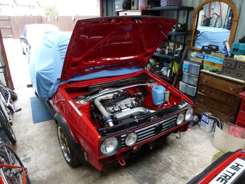

                Might even get it to look like this oneday...
                dreaming of it!
