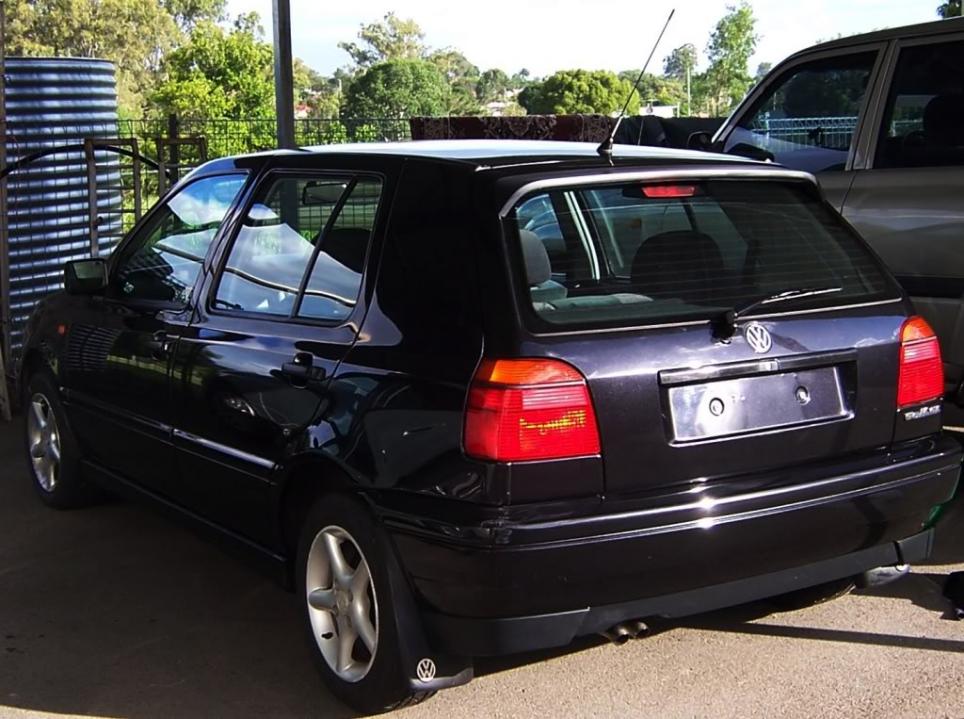

    I am new to VDubs. Just bought a 96 MK3 GL Golf for my Daughter. Picked it up for 2295 on ebay.
    Needs a couple of tyres. The Bloke who owned it bought it for 6700 a year and a half ago. I have cleaned it up a bit. It drives pretty good. Have There is a couple of things like the headlining has sagged but all in all I think it is pretty good. Few scratches reound the rear bar ... I am sure she will do a few as well being her first car.
    I have a few questions ...
    The passenger front and rear windows do not work ... Just a click when you press the button. Is this the dreaded Reg problem?
    The engine number starts with AGG... Is this a 1.8L or 2.0L?
    The VAG connector near the lighter. You can buy cables of eaby pretty cheap. Which one should I get and what software is good to use.
    I look forward to meeting you blokes in here.
    Cheers
    Max
    Max, That looks very tidy!
    Rosstech.com do the software and cable, although you could get away with an ebay cable on it and google the software
    AGG is a 2 litre, given away by the twin tailpipes.
    Dead windows could be electrics but the window regulators are made of plasticine.
    Gavin
      welcome and the car looks clean good buy. im sure your daughter would be stolked with that and hope she looks after it
        Welcome...very nice and clean car ...love colour...

          Hi Joe,
          Thanks ... It is pretty straight. It seemed like a pretty honest car for it's age. That is why I bought it. I spent the day polishing it and giving it a tidy up.
          It is funny. The bloke who I bought it from thought it was a 1.8. Here is the Vehicle data page off the service manual. It says 85Kw. Is that 2.0L?
          Mate ... We are not near a golf course. Dad who is 86 and lives with us played golf up until last year. We have a couple of acres and he uses the Buggy to get around the place.
          Cheers
          Max

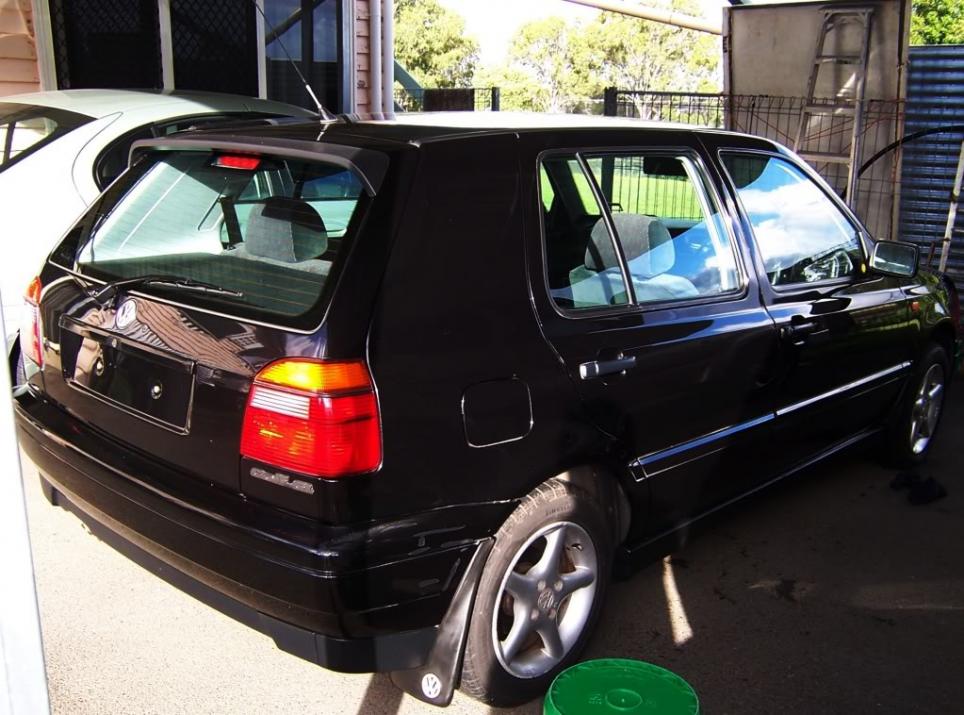

                Here is couple more pics ... I forgot to put them in.
                Cheers
                Max

                  Nice paint reflections!
                  The steering wheel could do with a fix up it looks like it, same with the gearbox, looks like you got the auto
