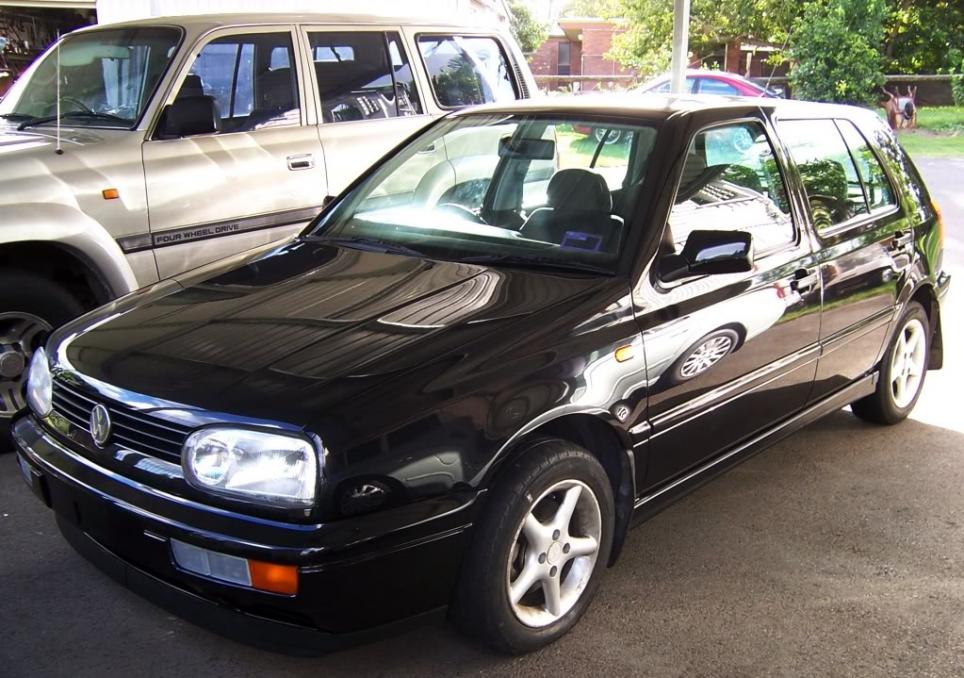

    I am new to VDubs. Just bought a 96 MK3 GL Golf for my Daughter. Picked it up for 2295 on ebay.
    Needs a couple of tyres. The Bloke who owned it bought it for 6700 a year and a half ago. I have cleaned it up a bit. It drives pretty good. Have There is a couple of things like the headlining has sagged but all in all I think it is pretty good. Few scratches reound the rear bar ... I am sure she will do a few as well being her first car.

    Max, That looks very tidy!

      welcome and the car looks clean good buy. im sure your daughter would be stolked with that and hope she looks after it
        Welcome...very nice and clean car ...love colour...

          Looks mint, Welcome.

          Thanks ... It is pretty straight. It seemed like a pretty honest car for it's age. That is why I bought it. I spent the day polishing it and giving it a tidy up.

                  Nice paint reflections!
                  The steering wheel could do with a fix up it looks like it, same with the gearbox, looks like you got the auto

                    Yer ... I know ... My daughter can't get her head around a manual.
                    I'll get to the steering wheel! LOL
                      Nice looking car, pity its an Auto
