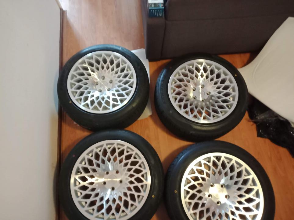

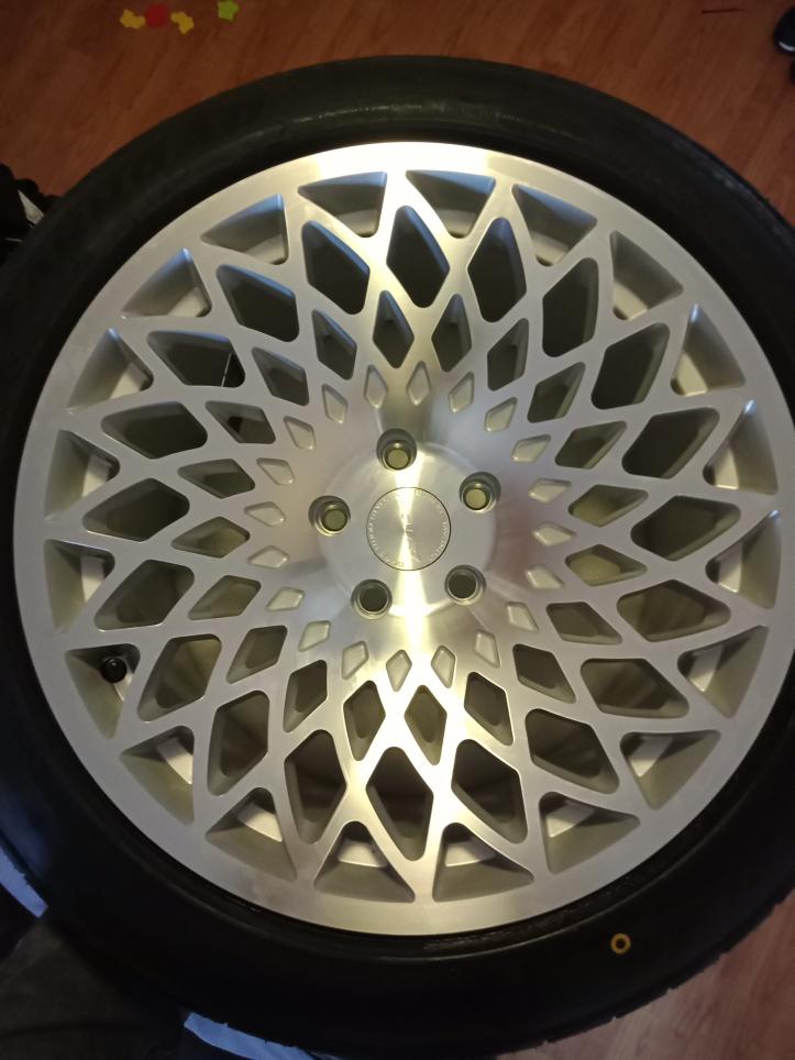

      There it is!
      The rims
      Can you spot the incompetent **** up?

        Nice!
