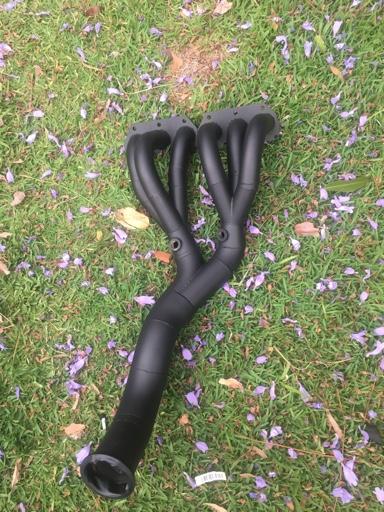

                    Header like this with a few other bolt on’s is showing good results on an R32 track car.
                    I’d be tossing up how fast you really want to go vs driver mod when looking at turbocharging a VR6 for circuit work. The amount of heat back there is taxing on a lot of the components even with excessive heat protection.
