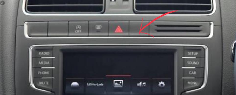

    I’ve got a VW Polo 6C1 and I’m hoping some people in here would be able to give me some tips on a little modification I want to do.
    Essentially, I want to add a button switch next to the hazard lights switch (pictured below), that will be able to open the garage door to my apartment complex. I have seen it done on here

      Awesome, thanks for that! Very helpful. Has anyone had a crack at removing the blank switch covers to get access to the wiring? I’m not to keen on trying to pry off the blank switch covers without knowing how it’s supposed to be done first
        At a guess you have to remove the surround of the radio first and those buttons are probably screwed in place.

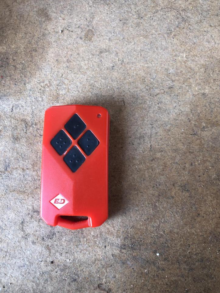

        I also grabbed out my remote and took a few photos for you
        Full Remote:

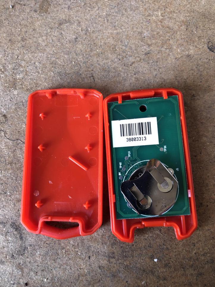

        Note you can't see any of the contacts on the back of this one:

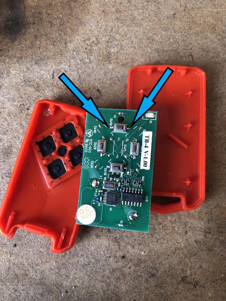

        Inside:
        You want to carefully remove the board and flip it over. On this side you can see the contacts on either side of the switches (arrows on switch one).
        You will want to solder your wires to either side of this switch and connect it to the new button. Essentially you end up with a second switch wired in parallel. It also means you can extract it and remove the wires quickly and easily and still have a working remote one day if you need to.
