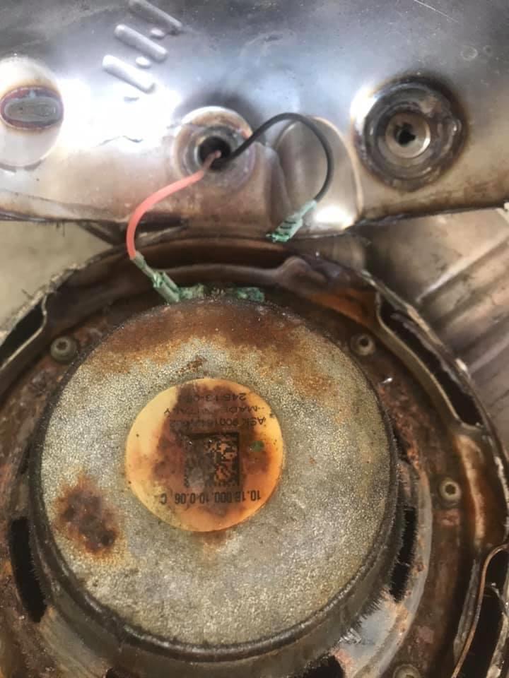

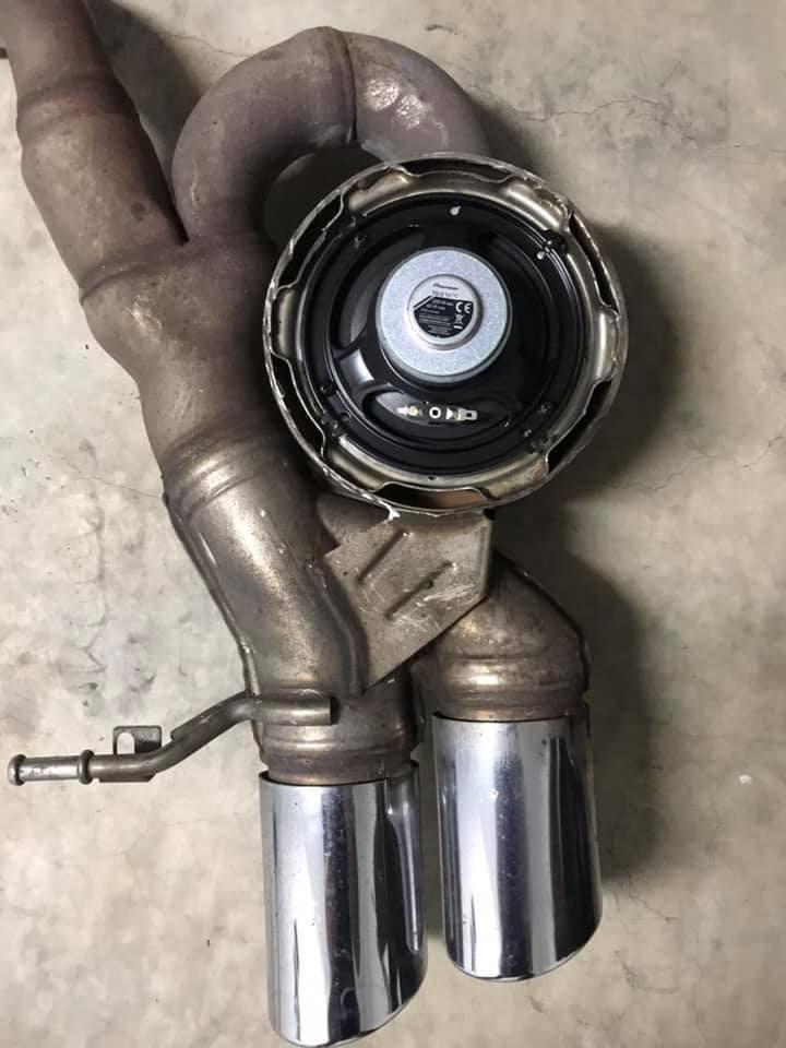

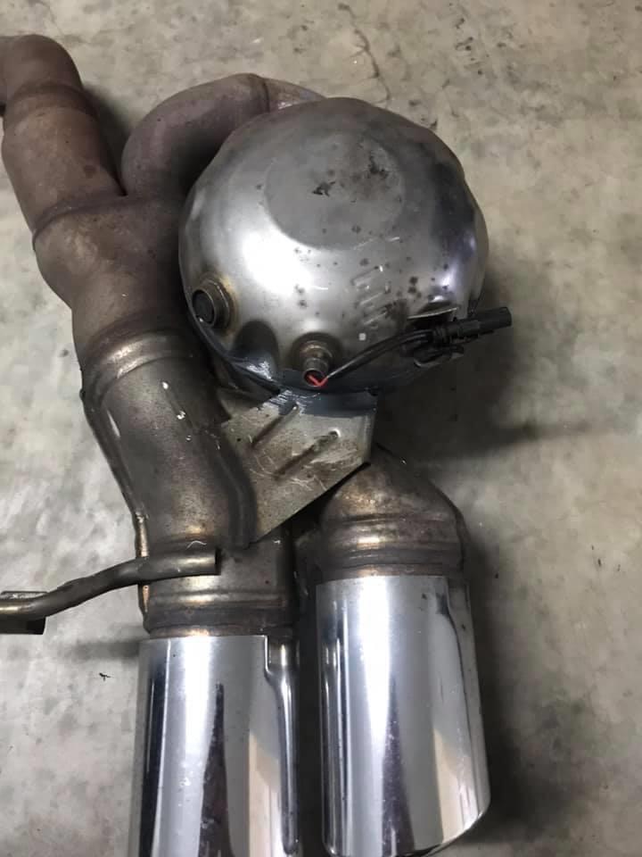

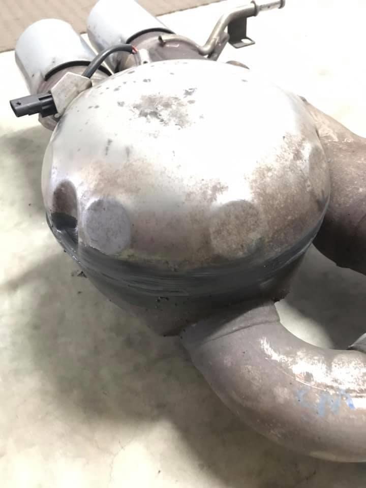

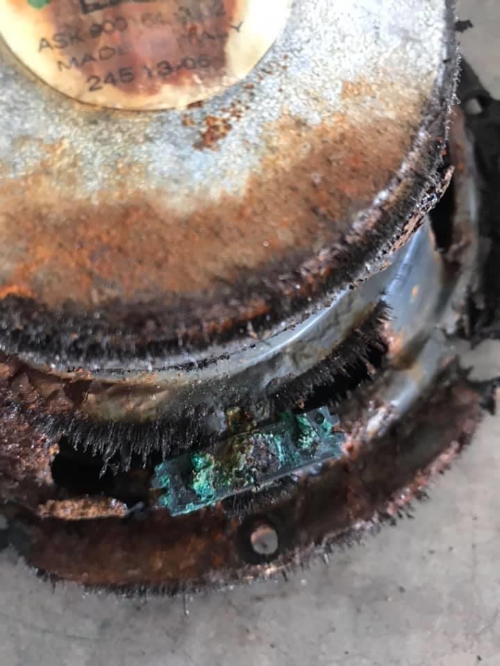

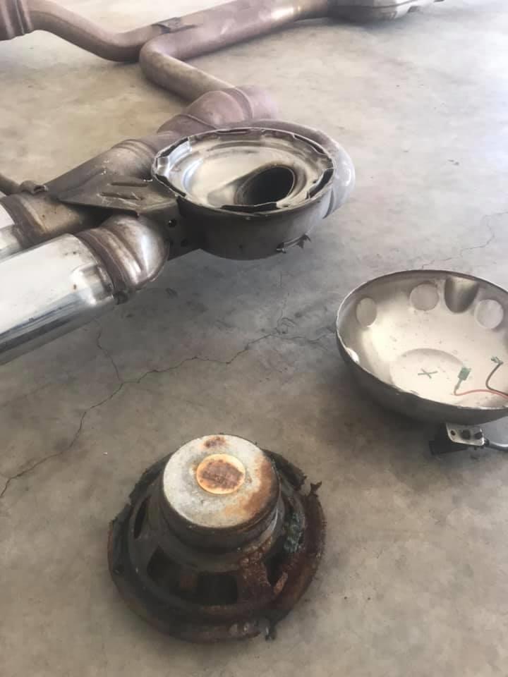

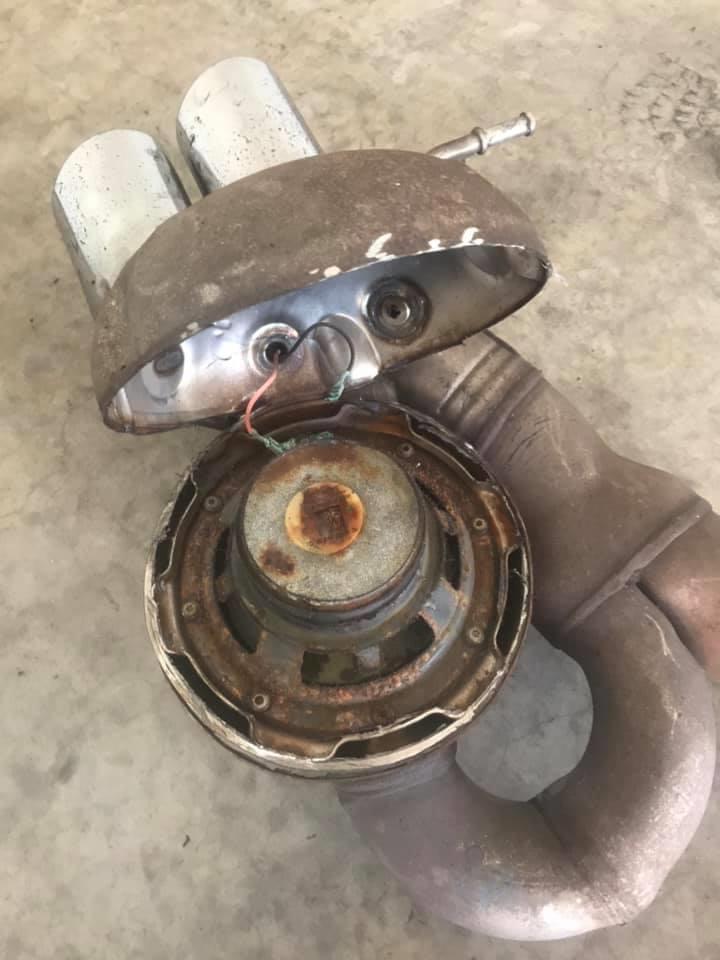

    Same car and same issue. The speakers actually rust and stop working. You have to cut open the chamber where the speakers are with an angle grinder, fit new 6.5" speakers and then either weld (or high temp silicone) the chambers back together.
    I just bought some speakers about a month ago to do this job on my SQ5. Most people go for a marine grade speaker which is more durable against rust to get the most life out of the replacement speakers.

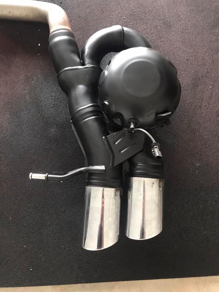

              Here are some pics ive saved from other people doing the job
              I was going to buy the Jaycar marine speakers myself (there is also a Pioneer speaker that has been used by some with success which is the TS-MR 1640 but these seem to be out of stock everywhere....perhaps discontinued?), but was recommended the Kickers and decided to go with those.
