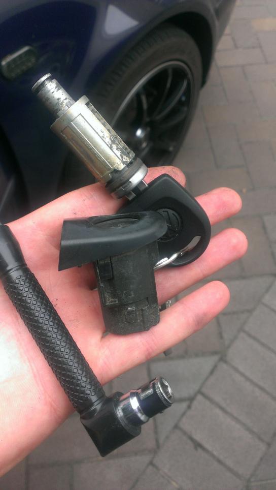

    Hi folks, I'm after the driver's side lock cylinder assembly for the Mk4. The module is fine, the cylinder is fine, even the housing is fine.
    All the other little bits are not! But prepared to buy the whole lock (minus the module of course).
    Willing to pick up anywhere in Sydney for a good price. Cheers.

      Hey mate, sadly they fell in as I jiggled the lock out. The housing popped out and got stuck (I later managed to fish it out) and everything including the spring dove into the cavity. If it helps, my passenger side lock looks like this:
        I will have a look later today what I have but I'm pretty sure the repair kits I have don't come with the C clip. They aren't fun to retrieve from the door cavity either
          OK, mine come with the clip so it should be all you need. I can do it for $25 plus postage.
            Thanks mate, got your repair kit today and installed it myself. Had to wrestle putting in the spring properly, but otherwise it works a dream!
