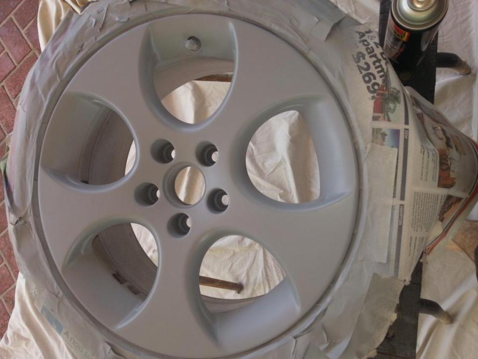

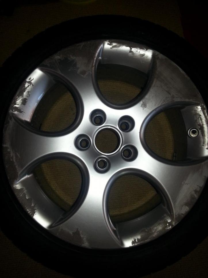

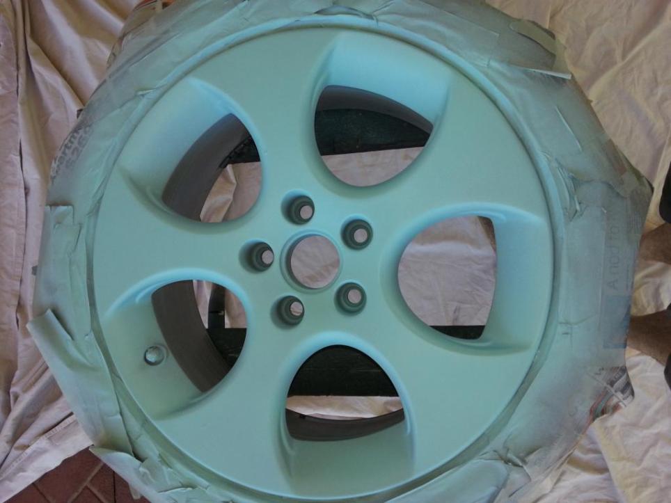

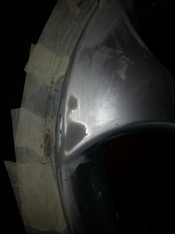

                            The wheels were fairly scuffed when I bought them yesterday so I've started a full re co on them.
                            bog filler
                            sanding
                            primer
                            spray putty
                            now to wait over night, sand back and start painting
