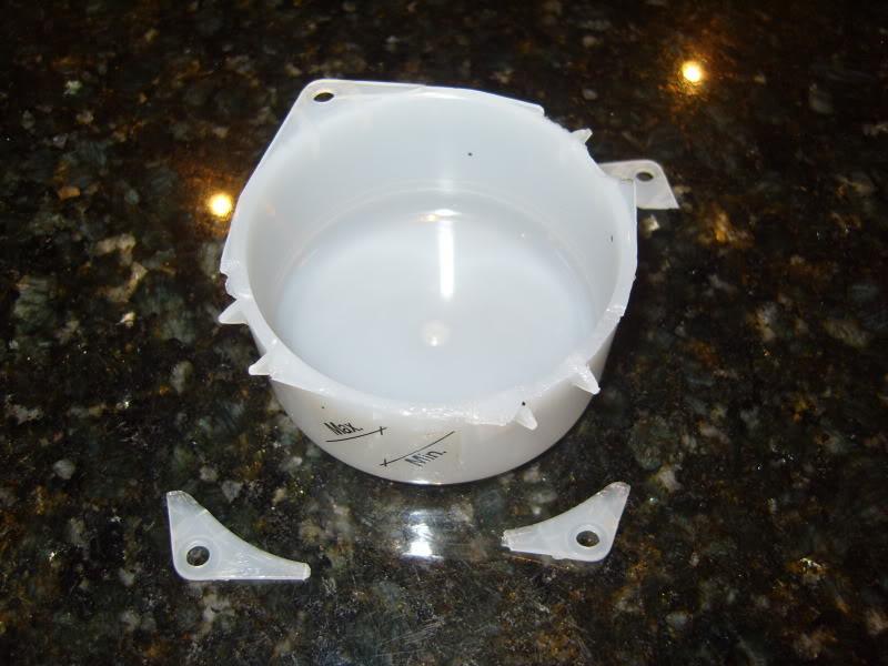

          This is whats happened to the thing.

            Mate, buy a bottle of the plastic guttering stuff they sell at a plumbing shop for melting upvc guttering together.
            It has a blue lid and basically coats plastic and attaches plastic together.
            Ends up solid and strong (and blue)
            I have used it to repair loads of plastic things and it is the grouse.
            Or call me and I know a bloke at Blacktown wrecking a couple of cabrios
            • #21
              Cheers Loon. Was gonna try and glue it somehow, but didn't think it would take the pressure.
              I'll give the blue stuff a go and if it explodes will give you a bell haha.
