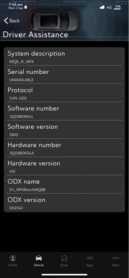

          Hey mate! I’ve sent you a PM, I’m just wondering if my 2020 Audi S3 has the complete wrong part? Is it the hardware version or the software version?
          • #35
            My Tiguan R-Line has exactly the same model, SW, HW and version...
            Also keen to know if it's supported
