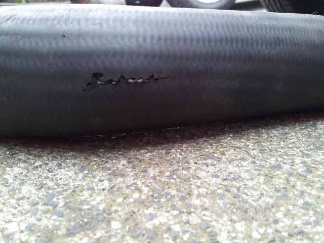

          After I split a 3 month old silicon pipe last week at happy laps, I would probably make a list of each joint and pipe, then inspect each one individually, tick them off as you go.
          This is what I did and luckily it was the first one, even though the clips were tight, I missed the 3 inch split the first time round as it was on the side facing the firewall which I couldn't see.

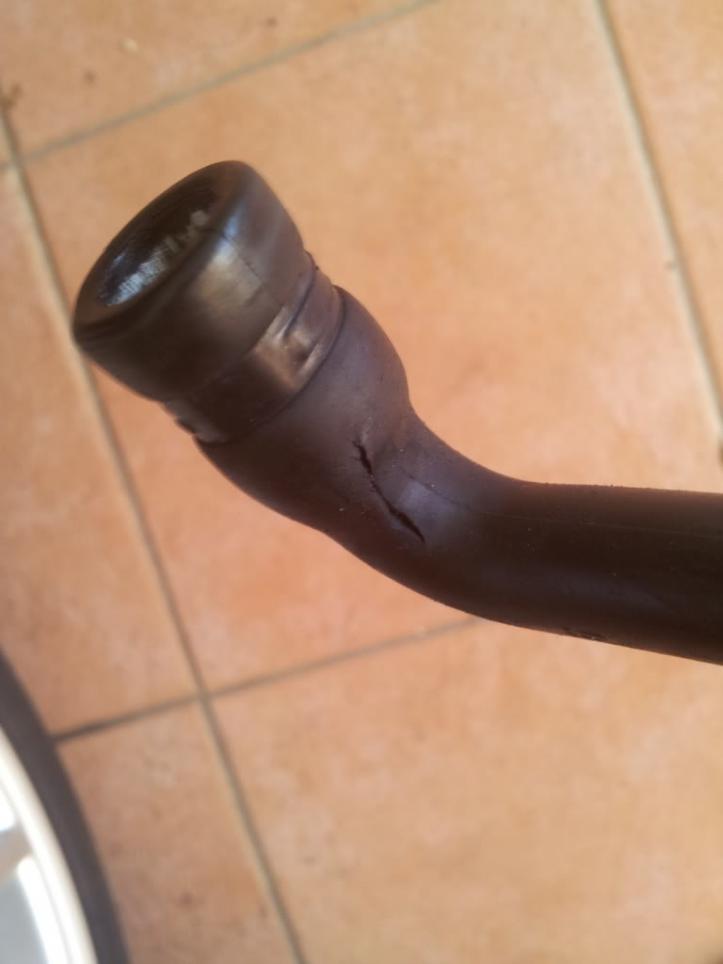

            there's a pipe that connects at the bottom of the intake manifold for the pcv system that gave me all sorts of issues.
              Also available in silicon I reckon.
              Would be found by the smoke but a physical would catch it too.

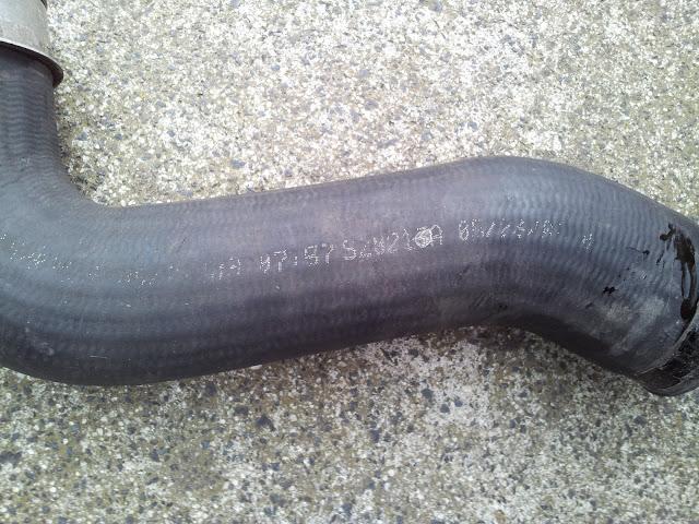

                I can beat that
                If there was an upside it sounded like I had the intake mod installed with all the wooshing sounds
