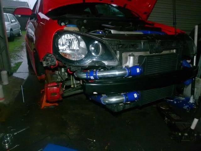

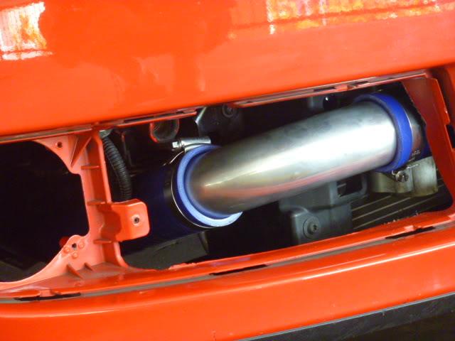

          The front of the polo is very restrictive space wise, even more so with a massive front mount to fit in there
          so you don't get a heap of choice as to where you run your piping. In this case right in front of the factory tow hook receiver hole.
          So with all the track work I'll be doing I need a solution and that solution is a strap that can fit around the piping hence needing a bolt with the same thread as the factory tow hook.
