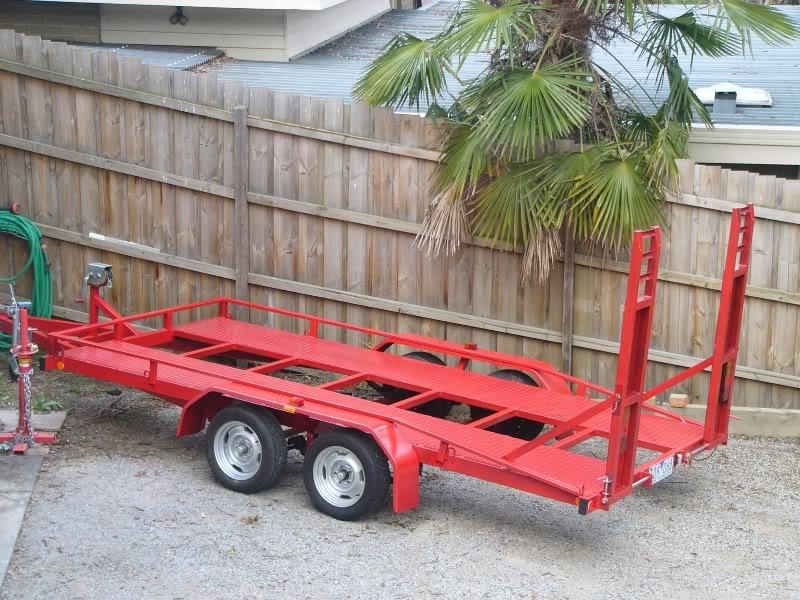

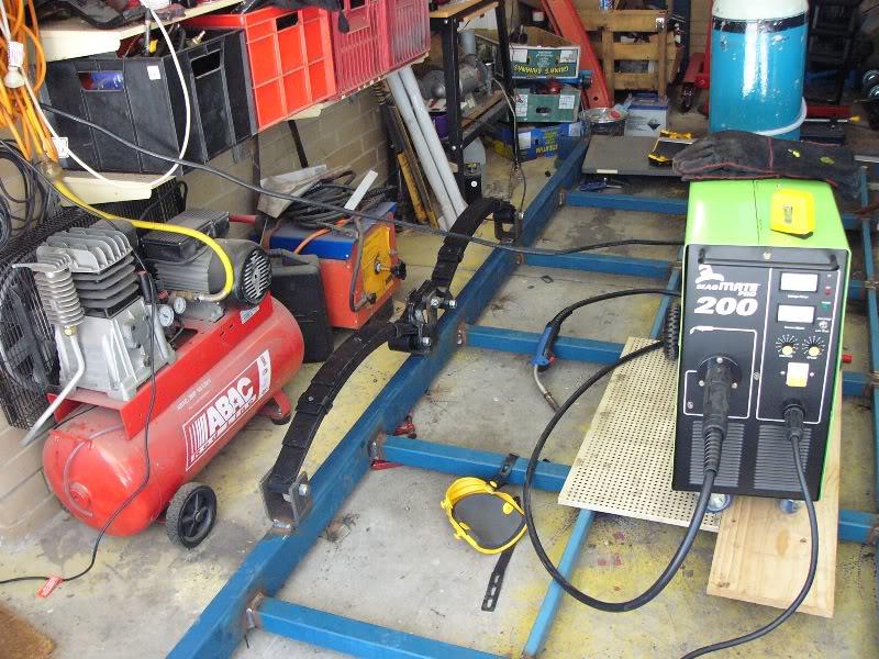

            I bought one and made this.
            and I fixed some rust

              Trailer's pretty amazing Pete!

                  Nice trailer.
