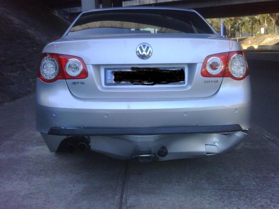

Well hey I hope you get what you want. As others have mentioned, it's good that no one was injured and hopefully your neck turns out fine.. I dunno but it's just disturbing looking at that Jetta with the inverted bumper. Good to hear (I guess) that the tow bar took most of the damage therefore preventing serious panel damage..Originally posted by VW Convert View PostThanks for all your kind words guys, I've included the only photos I have at the moment.
The damage looks minimal on the Jetta, the towbar took the brunt of the hit which means cosmetic damage is minimal but the big question mark is how much of the impact was transmitted through the towbar to the subframe etc. As I mentioned before, my main concern is that the R/H/R door to body gap appears to have widened and the L/H/R door to body gap has narrowed indicating the body has twisted slightly. The bootlid is also skewed relative to the boot opening. This may be repairable but it cetainly is a major repair
despite the seemingly minor nature of the damage.

As VW Convert says, towbars hide the real damage. Someone in an old beetle ran into the trailer attached to my dads Falcon. The only cosmetic damage was a cracked tail-light on the trailer, nothing on the Falcon. However, the force had transmitted through to the left rear axle, bending it, which cost a grand to replace.Originally posted by maca View PostGood to hear (I guess) that the tow bar took most of the damage therefore preventing serious panel damage..MY14.5 VW Polo 81tsi Comfortline - Candy White - Comfort Pack

Not sure which one came off worst really, the Jetta has virtually no panel damage apart from the bumper bar but the distortion to the body is the major concern. The bootlid fouls the guards (circled in the photograph), as the guards and bootlid are not damaged, this means that the two guards have been pulled inwards indicating subframe damage. Add this to the fact that the door gaps are wider on one side than the other indicates a twist in the body.Originally posted by anthony View PostIt looks like the Lexus came off far worse than the beloved Jetta,what a shame,poor car...

I saw my beloved Jetta for the last time today, I went to collect my belongings as she is now a write off.
It was touch and go but it would be a very major repair and whilst one part of me would like to see her repaired, the realistic side of me says two big hits is two too many and I'm better off with a new car. I have no doubt however that she will be repaired by whoever buys her at auction, she hardly looks marked, I just hope they repair her properly and someone does not end up with a bodgie a car.
