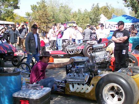

To be honest, it was pure luck! When we were at the California Hot Rod Reunion last year (2007), we were walking around looking at the cars and we started talking to some guys there with cackle cars saying we were restoring one and needed some info on a cackle engine. They said "See that guy over there with the fire suit pants on and the mustache? That's Rick Macdonald, go and talk to him, tell him we sent you."
So we walked over, introduced ourselves and got talking. He gave us some info on the spot and some contact details. He's been helping us ever since!
Dad and mum went back for the CHRR this year in october again and dad spent about 2 full days out of the 3 they were there for it with him. Learned heaps.

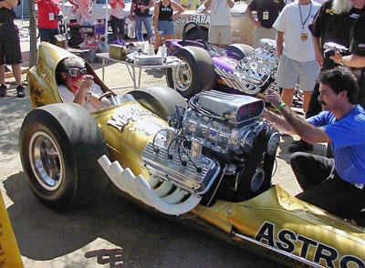

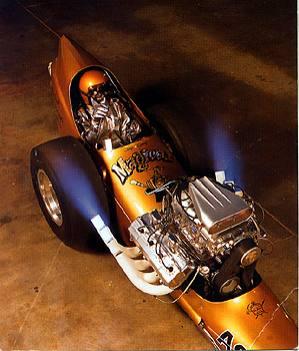

This is Rick in both pics at the CHRR this year adjusting the barrel valve on the "Magicar" owned by Bill Pitts (another long distance friend we've made).
And here is is running at night. Those header flames are small compared to what it can produce with the right tune up on 100% Nitro. Our setup is going to be fairly similar.
