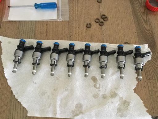

    Ok iv given up
    This is my last resort,
    Does anyone know if there is anyone in Australia who can clean and flow test Audi FSI injectors ?
    Iv called up every injector shop and they all say the same thing.
    They don’t have the equipment to carry out a flow test for direct injectors.
    What the hell is going on?
    So does anyone know anywhere in this country where I can just send my injectors to get cleaned and tested before I can install them.
    Being that its going to cost around $190 or so per injector for new ones and I need a total in 10 done, buying new ones is not really a justifiable option.
