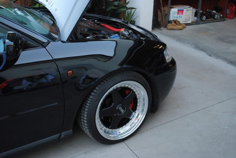

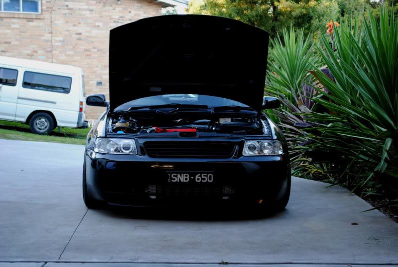

finally had some time to paint my intake and polish the throttle body, not sure about the wrinkle red but im not taking it off again. pained the letters on the engine cover and got that back on to hide that ugly valve cover until i decide to do something with it.
thanks guys!
just a note for anyone that will be removing the intake/throttle body, don't forget to recalibrate the throttle body after mounting everything back together. you can either use vag-com or disconnect the battery (-ve), leave it for 10-15min, then turn on the ignition and you'll hear the throttle body adjusting. it slipped my mind and i hardly made it home, had a bunch of errors come up on the vagcom

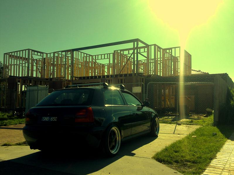

been a while...haven't done anything with the car for months, roof racks have finally paid off...took out the rear seats/spare to move some stuff and they are not going back in, nobody ever sits there anyway...i can definitely notice a difference, thinking of installing some light front seats, anybody know what fits?
