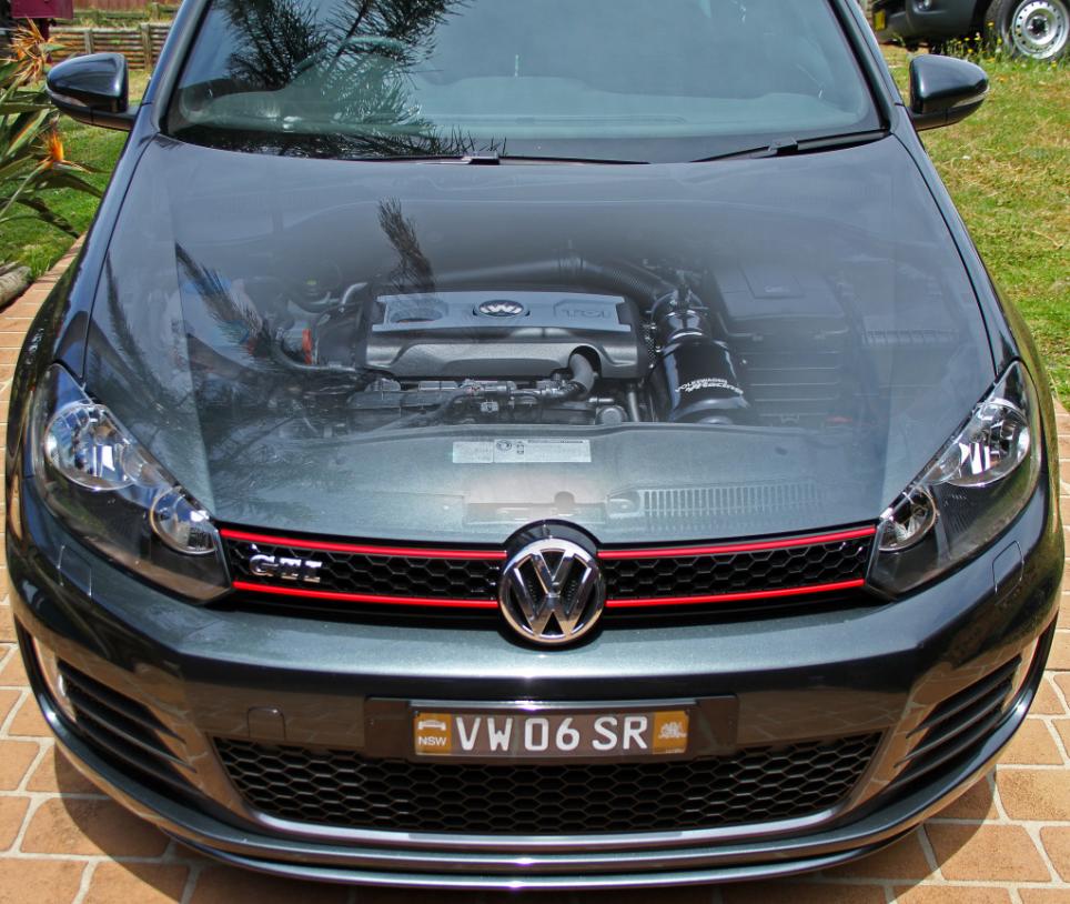

    Upgraded the 118 twincharger in June to a CSG GTI and have only just got around to getting some pics together so I can start this thread.
    The difference between the vehicles is quite subtle at first (apart from the obvious power advantage.) But the longer I drive it the more I believe that this is a better vehicle. With all the DSG issues and more with the 118 I must admit I felt a little nervous the longer I kept it. So we decided to bale on it just as the warranty was expiring.
    I have titled this a 'slow build'. It will be, but I am happy to say that the mod bug has bitten
    I'm looking for a sleeper, one that goes under the radar and doesn't look like it goes. I won't be dropping the suspension, although I understand the benefits of one that keeps the car planted and sure footed on the road. I have only a few mods so far, but the latest one has been one of the best.
    Some time ago I contacted John at DNA Tuning regarding a stage 1 upgrade. His responses made a lot of sense to me, he didn't try and rush me into a sale for the sake of it and advised me to wait until I had 5000km on the odometer. I think he runs a thoroughly decent business. The only little issue was that nobody could tell me if my ECU was anti-tune and as John was in a different state it made things a little difficult as I couldn't afford the vehicle off the road.
    Move forward a few months and I see John Robinson from Tigersoft advertising his Bluefin device. I sent a PM and we basically clicked straight away. I ordered my unit last Tuesday afternoon and John was straight back at me to apologise as the order had come in after the freight had gone for the day. He kept his tracking updated on his site and I received my package on the Thursday morning, overnight from Melbourne.
    I followed the simple instructions and downloaded my new map from Superchips UK on Friday night. Nervously I loaded the map into my OBD port on Saturday morning. The MFD flashed a spanner symbol & I thought that the anti tune would prevent my progress. Nope! The controller signalled that everything was successful and so I started the car. WOW!!! What a difference. The mid range torque was quite addictive. It pressed me back in the seat and the speedo seemed to rise so much more quickly.
    I seriously have not been able to take the smile off my face all weekend long. Without getting into tuner war zone territory I can highly recommend the Bluefin. It gives me the ability to change back to stock too, whenever I decide to.
    I would also like to endorse Tigersoft Performance. Even though they are in Melbourne and I am in Sydney, John made me feel like his most important customer, a rare occurence these days.
    Thanks John.
    Thanks if you managed to get this far.

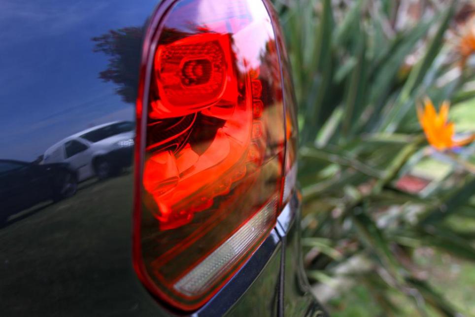

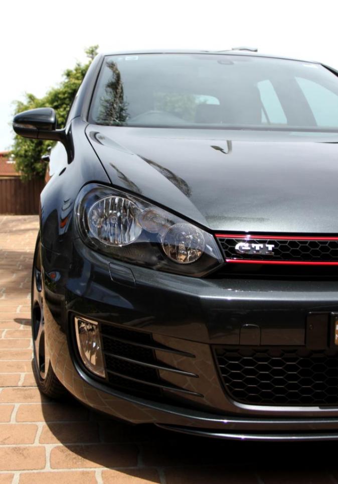

    Love the last picture. Just looks stunning.
    Congrats on the Upgrade!
      Thanks very much for the kind words Ozram, you are a very easy person to do business with.
      I take it you are into detailing as well? That GTi looks pretty nice. Loving the last shot, I'm going to have to try that after I finish the detail on the E39

        Thanks for the kind words guys, I think I used a bit too much polish on the bonnet
