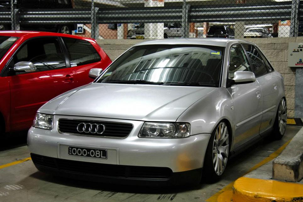

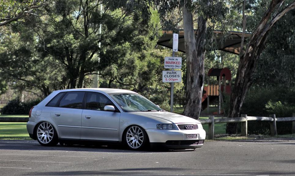

Blank canvas (installed Dieselgeek short shifter and deleted rear wiper)

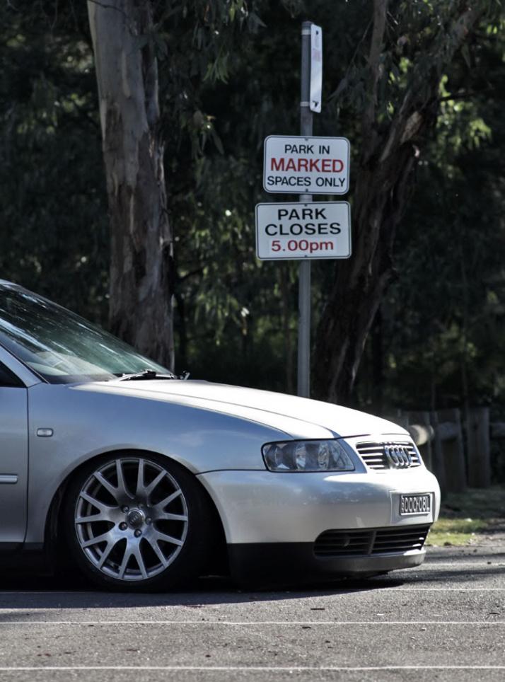

Wanted to get it ready for Dubstitute back in January, so bought some cheap coilovers and refurbed a set of Work Rezax (final specs of 17x9 ET23 on 205/45R17 front, 17x10 ET30 on 225/45R17 rear)

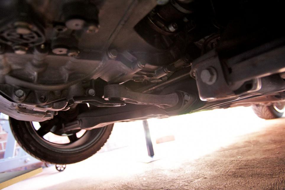

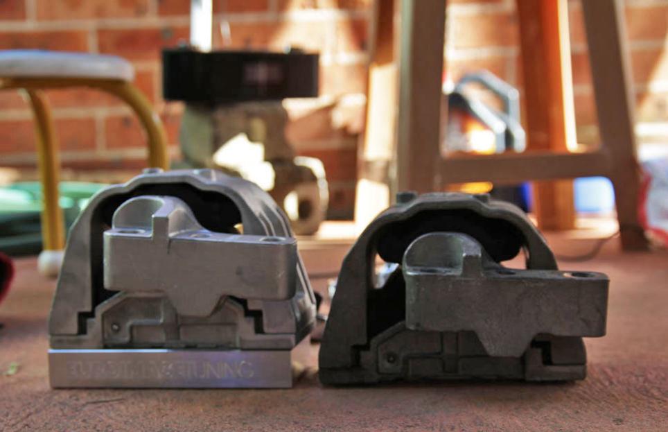

Replaced engine mounts with 034Motorsport uprated "Street density" mounts (stiffer rubber, but ride is still very comfortable and no in-cabin vibration, very happy with them). Also installed EuroImageTuning 1" engine mount spacers too:
Engine mount spacers also had provisions to allow the dogbone to sit correctly but I didn't put them in, gives me slightly better ground clearance:

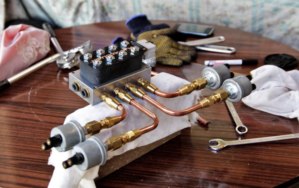

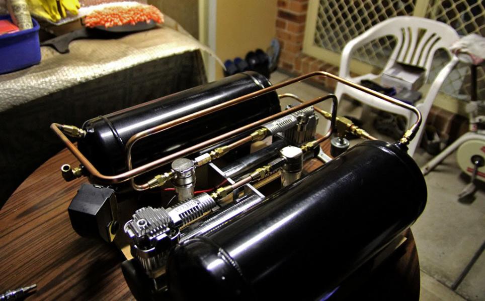

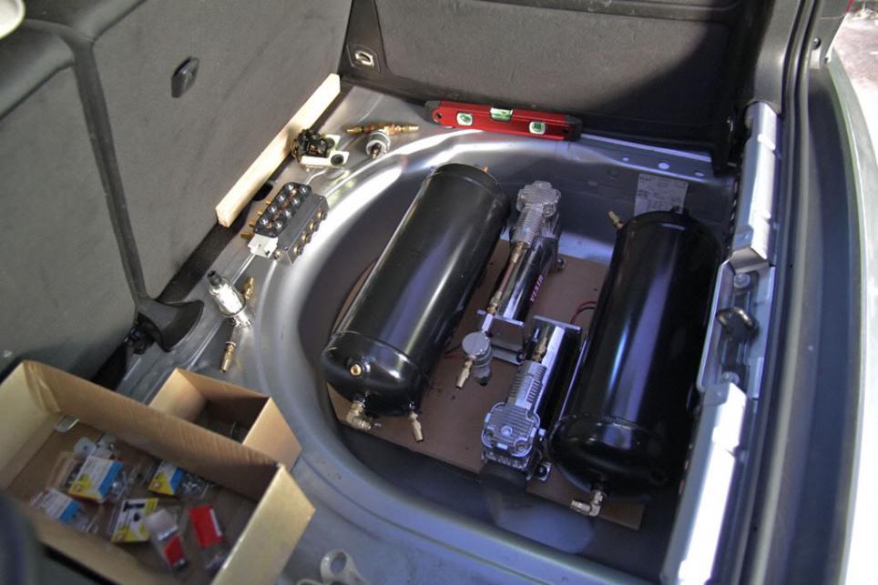

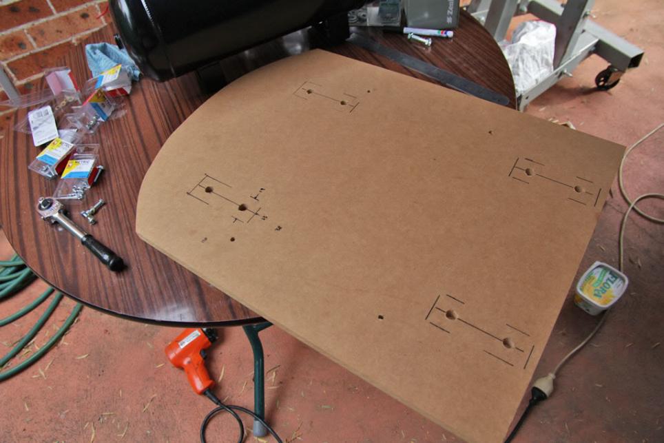

And the party piece, the airride. Some pics from the build at various stages:

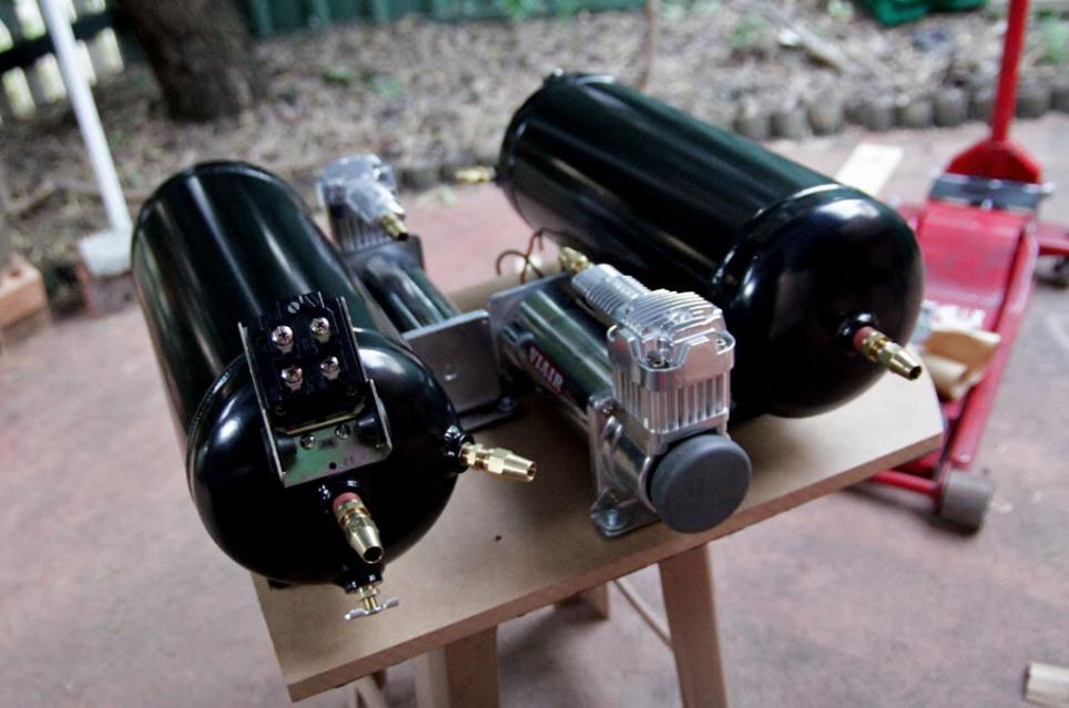

Two 3 gallon tanks, dual VIAIR 444C compressors

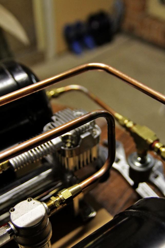

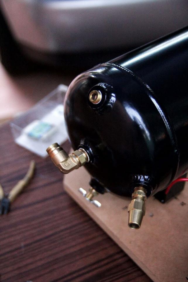

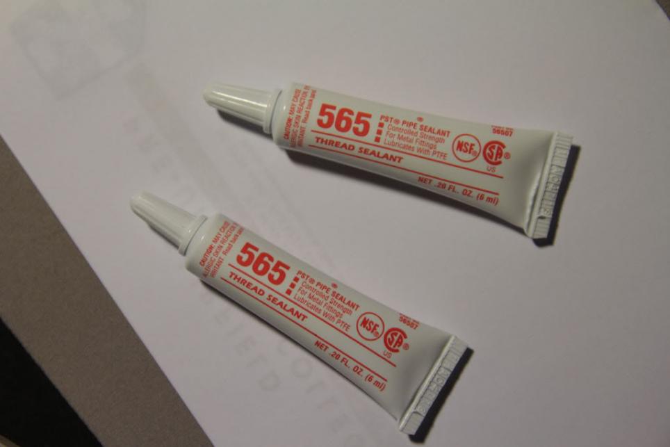

For leak-free operation

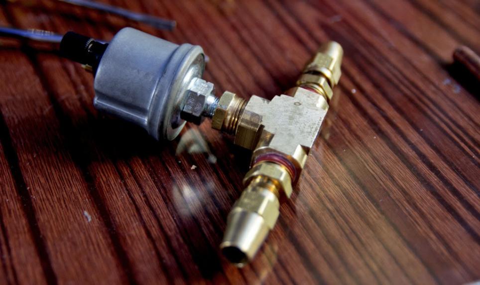

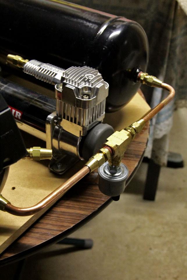

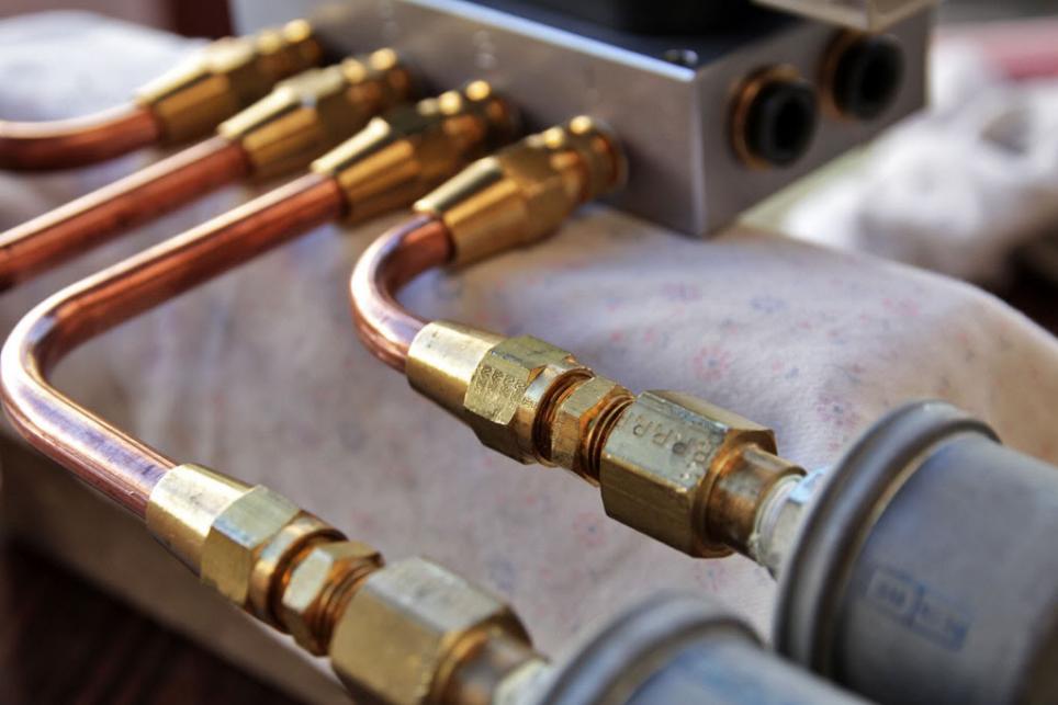

Parker-Hannifin and Eaton fittings (air-brake compression and PTC)

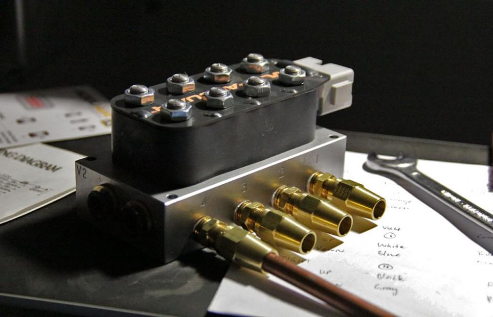

Accuair VU4 valve block

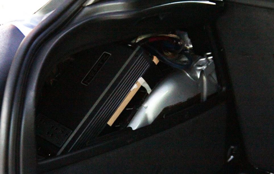

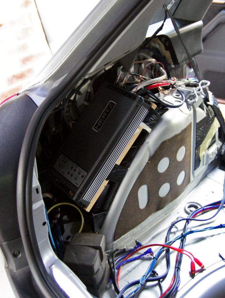

Hertz HDP5 amp
Hertz HDP5 amp
