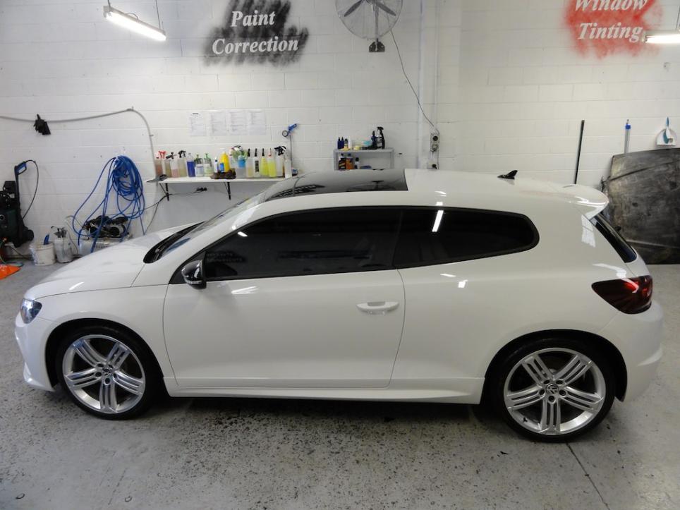

    Then it was straight to see David at Reflect Effect for a bit of Opti Coat loving and Paint Decontamination to clean up what the dealers left behind.
    I then matched the tint all round. The Scirocco rear and privacy windows are pre tinted but were also tinted to match the front. Gives it a real Storm Trooper look.

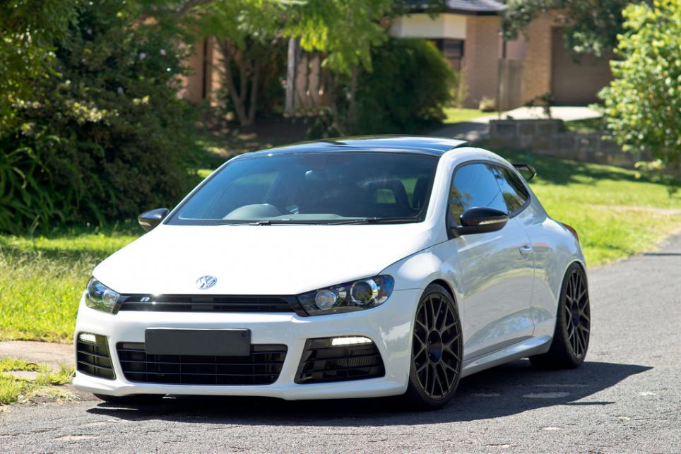

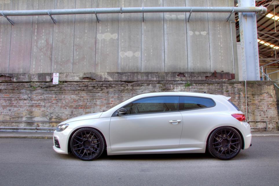

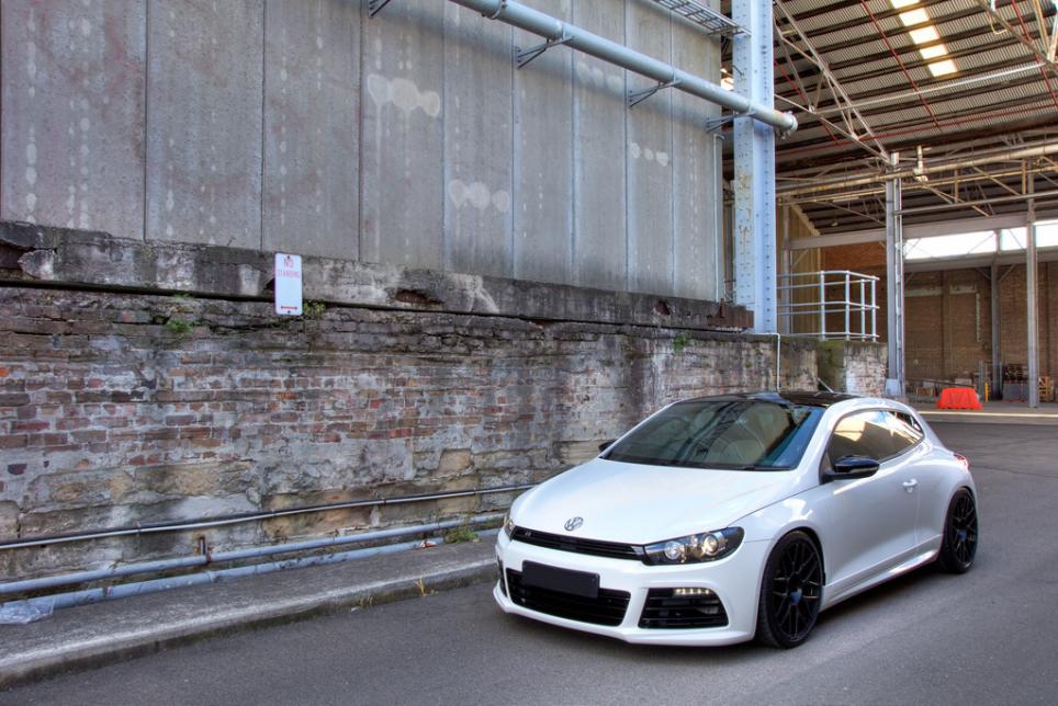

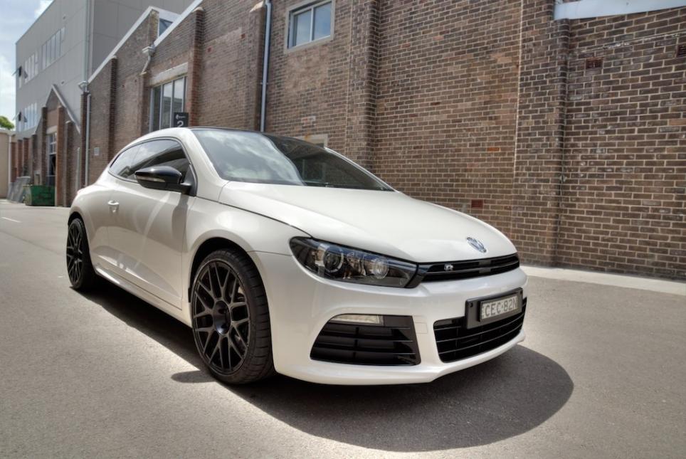

    Couldn't wait for my suspension so put my new wheels on with some fat rubber to fill out the guards.
    This is a better angle as it looks less like a 4WD...
    Wheels are ADV8.1 Forged One Piece
    19 x 9.5 ET35
    Tyres are 265/30-19 Michelin Pilot Super Sports
    The wheels are now lighter by over 1kg each corner to OEM 19's with the bigger rubber.

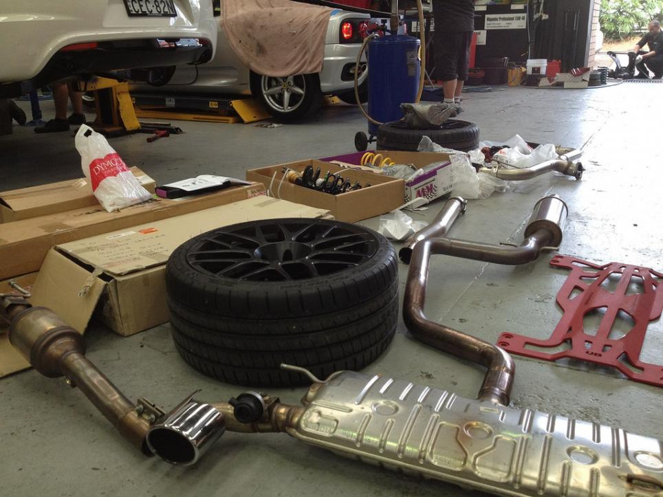

    Big week of mods! Suspension and Exhaust.
    ---------- Post added at 12:09 PM ---------- Previous post was at 12:04 PM ----------

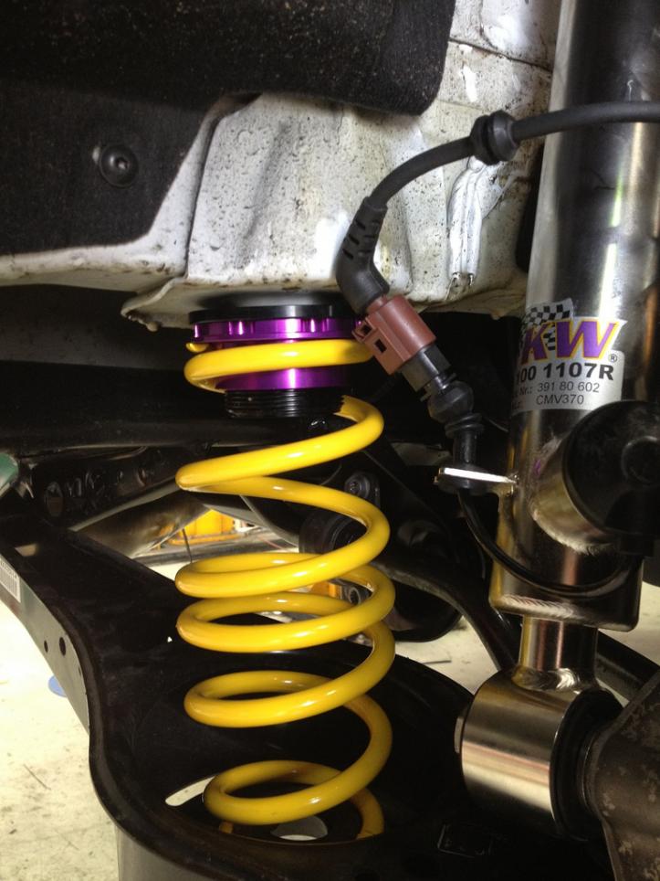

    KW DCC Kit
    Rear wound all the way down...
    ---------- Post added at 12:20 PM ---------- Previous post was at 12:09 PM ----------

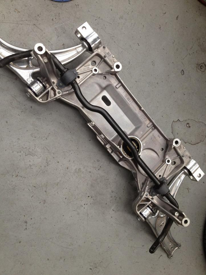

    H & R Bars Front and Rear

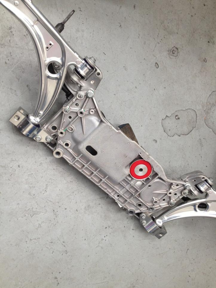

    Alloy Control Arms and HPA Dog Bone
    The control arms are really light!
    ---------- Post added at 12:25 PM ---------- Previous post was at 12:20 PM ----------

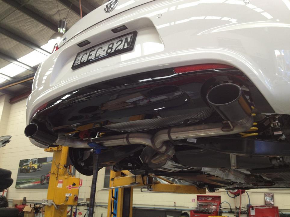

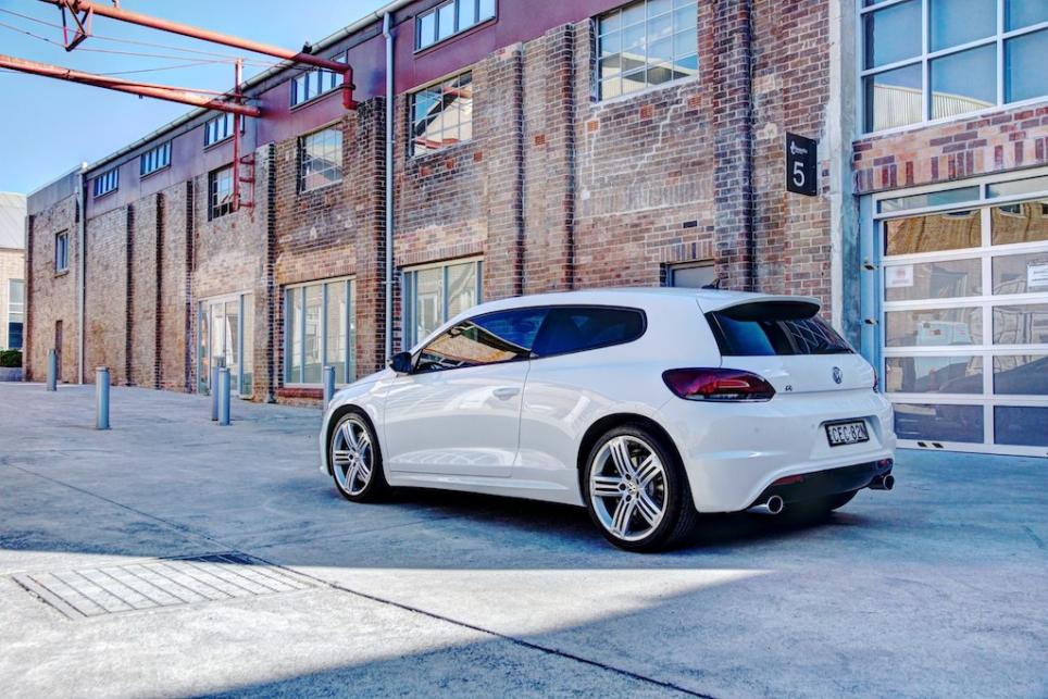

    Milltek Unresonated TBE
    ---------- Post added at 01:40 PM ---------- Previous post was at 12:25 PM ----------
    .....and the end result.

          Thanks dude. I think the Silver Talladegas are nice rims but they are a conservative setup. There is heaps of room under the guards and you need to fill them out so the car looks nice and fat! My set up is the largest and most agressive you can go for the car without scrubbing. Stock offset is ET41 on a 8 inch rim with 235. I am running a 35 offset on a 9.5 width rim with 265 rubber!

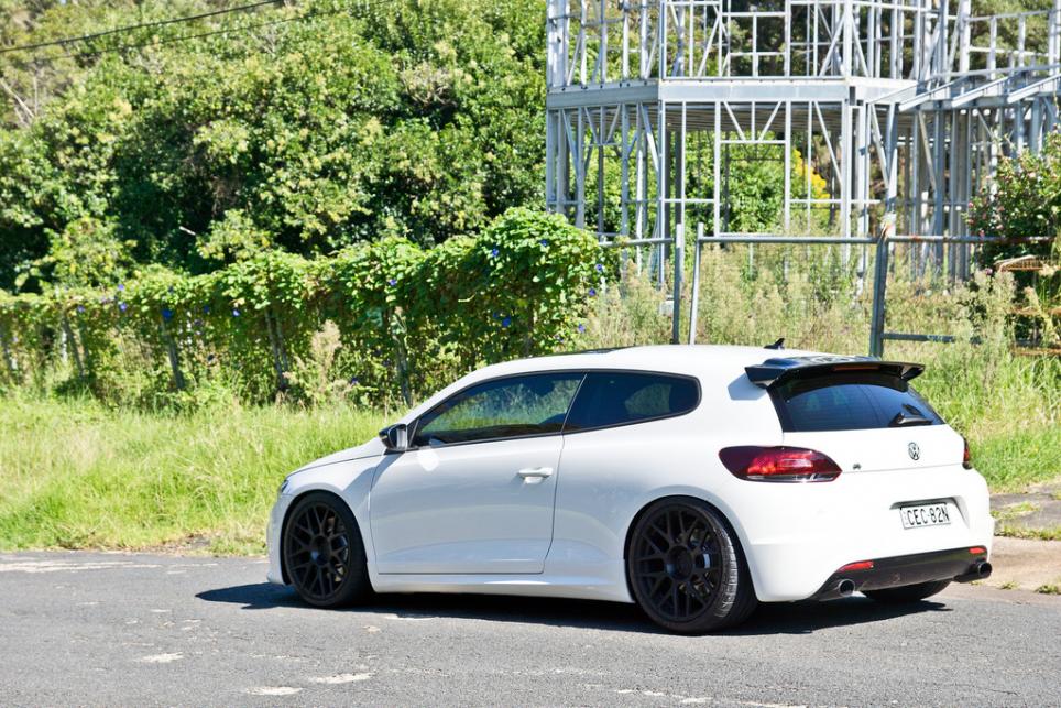

                          A bit of surgery today.....

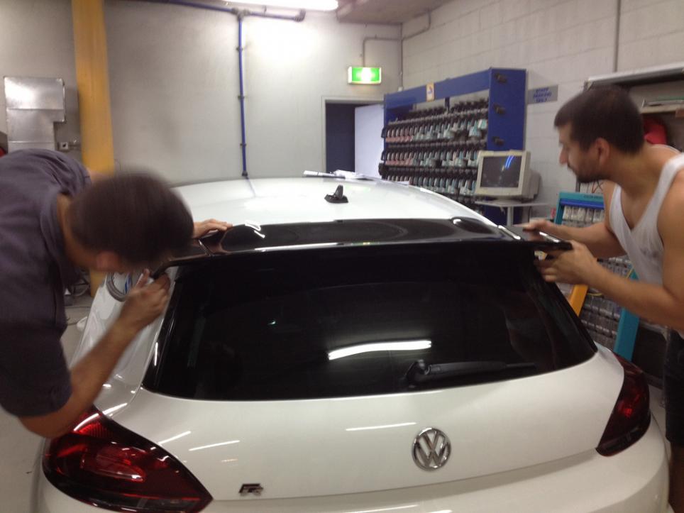

                          After much deliberation I took the plunge and fitted the Cup Spoiler today. It was not as straight forward as I thought.
                          1. The stock spoiler comes off easy enough as its just attached by bolts
                          2. The Cup spoiler has no bolt holes and needs to be glued on. This thing is permanent so fellow scirocco owners you need to be sure!
                          3. Although listed as an OEM part it doesn't fit properly. Ian (Renenhaus) had the same issue. A bit of cutting/sanding is required

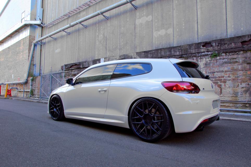

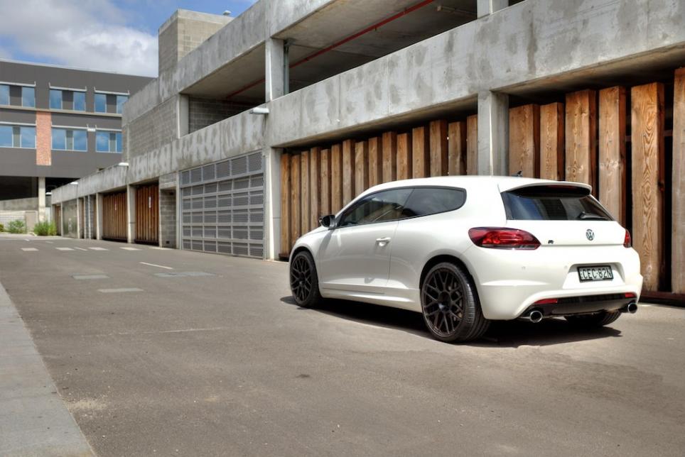

                              Like you I was also unsure and was also scared about spoiling the lines, however it is reversible unfortunately you just have to destroy the spolier pulling it off. However I was pleasently surprised, I dont think photos do the spoiler any justice. It does look better in reality and it makes the back end even wider and lower.
                              Here are some preliminary pictures at various angles.
                              What do you think?
