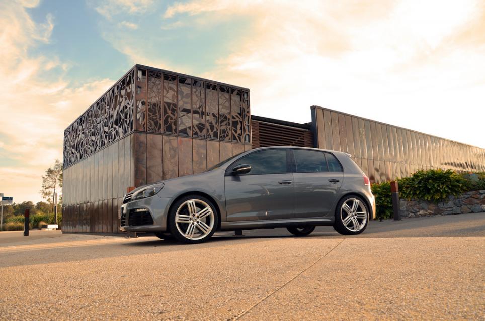

    Car in its stock form
    Golf R-Front B&W
    Golf R
    Golf R
    Golf R

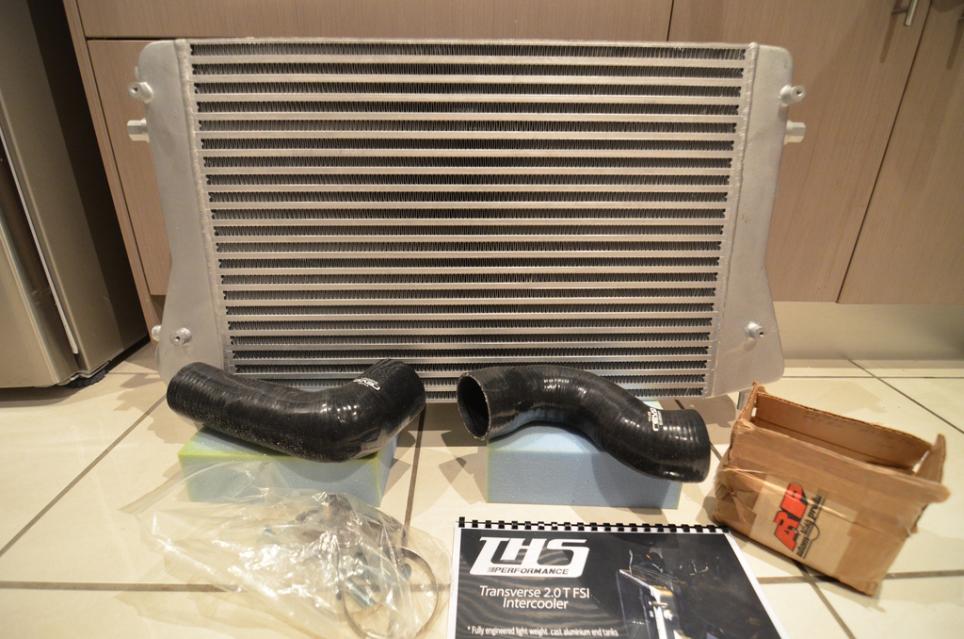

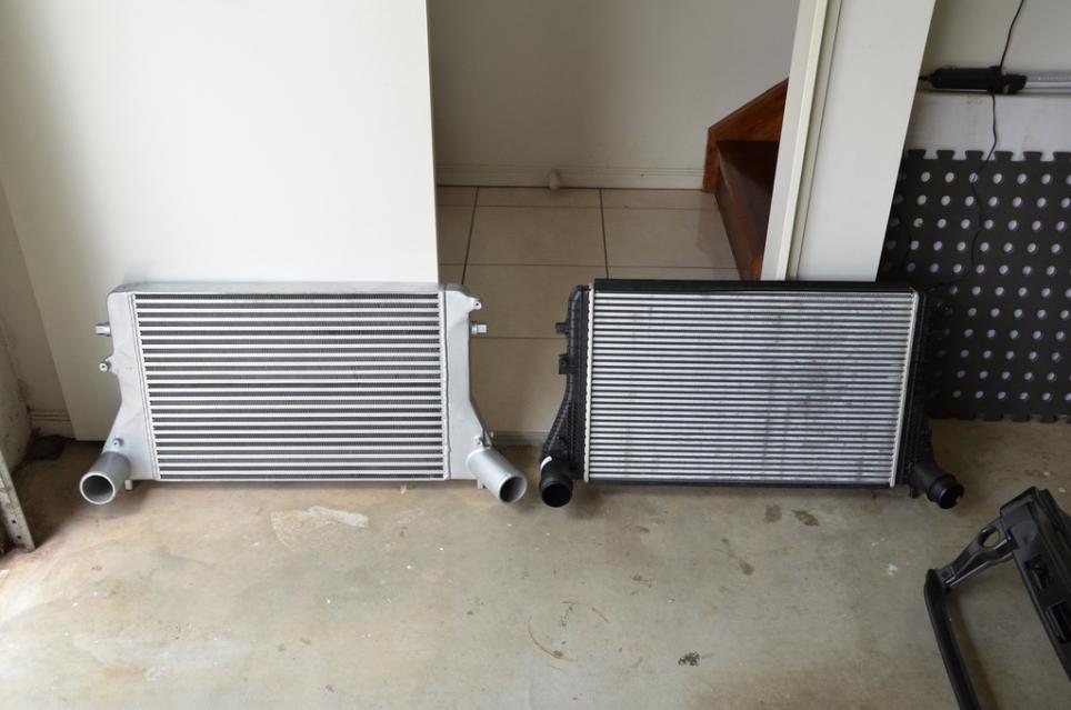

    THS Intercooler
    THS Intercooler

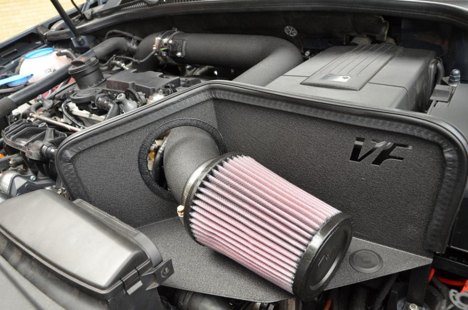

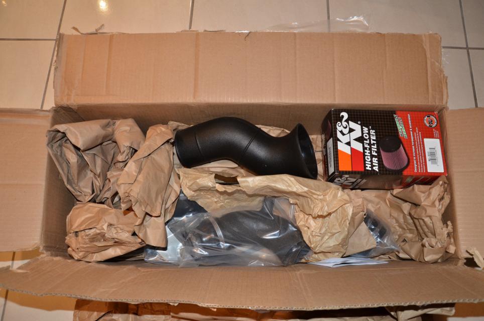

    VF Intake
    VF Intake

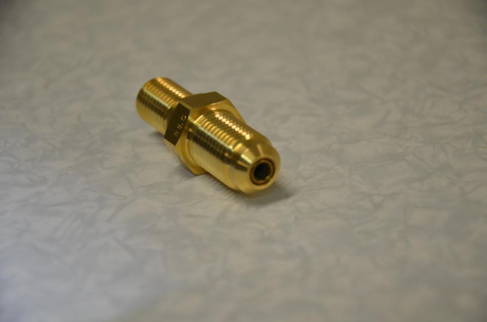

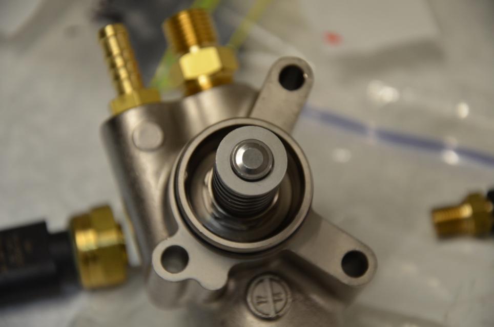

    HPFPupgrade Pump
    HPFPupgrade Pump
    HPFPupgrade 142 Bar Rail Valve
    142 Bar Rail Valve

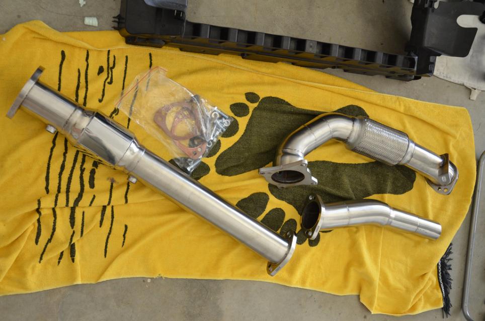

    Turbo XS Dump pipe- Stealth
    TXS

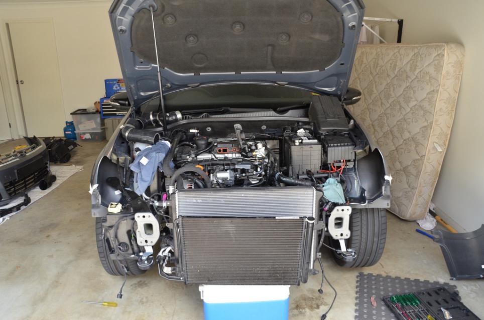

    Actually doing the work myself

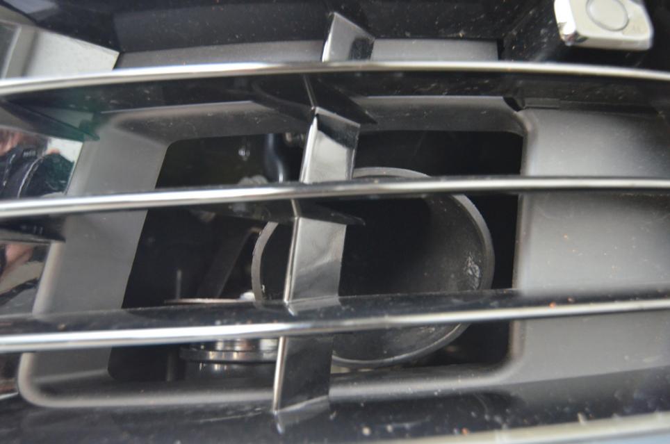

    Front, no cooler
    Intercooler THS Vs OEM
    Stock vs THS

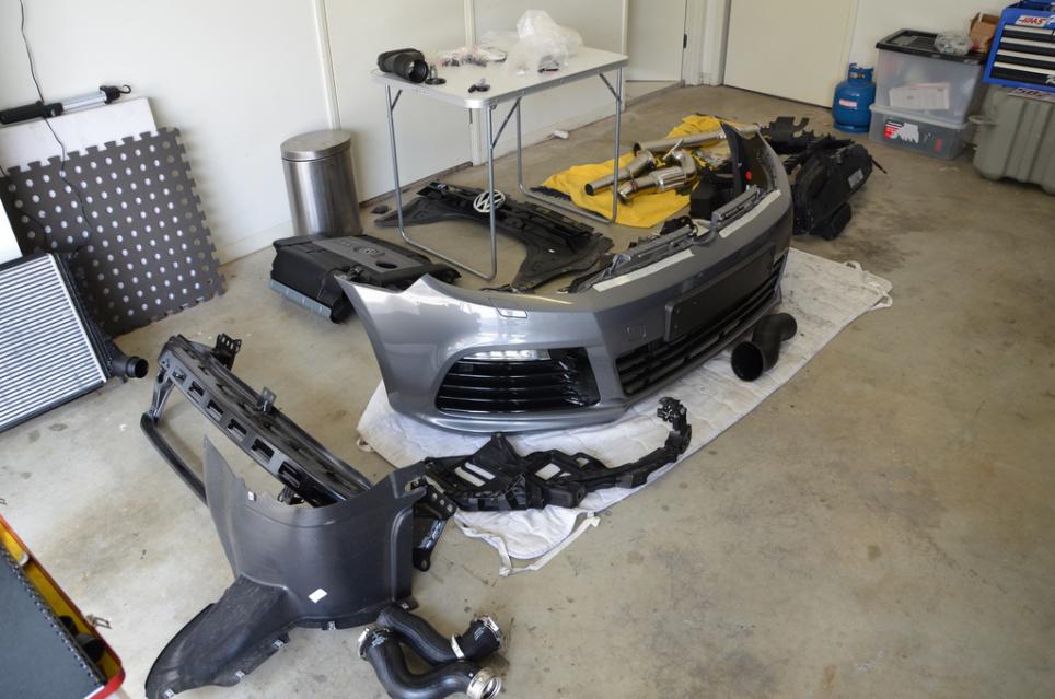

    Parts everywhere
    Parts

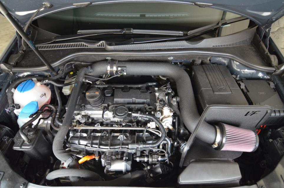

    VF Intake installed
    VF Intake
    VF
    CAI scoop. Sorry DSG guys, you can’t fit this
    Intake
