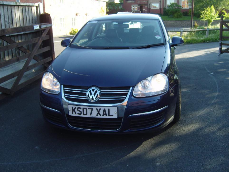

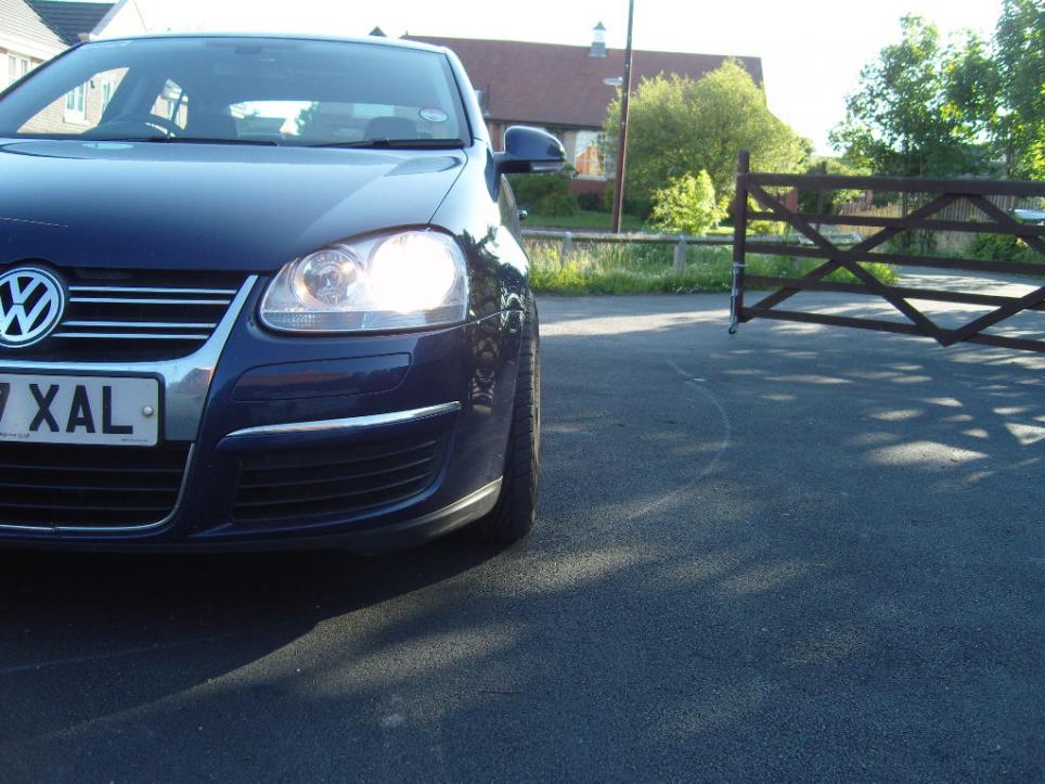

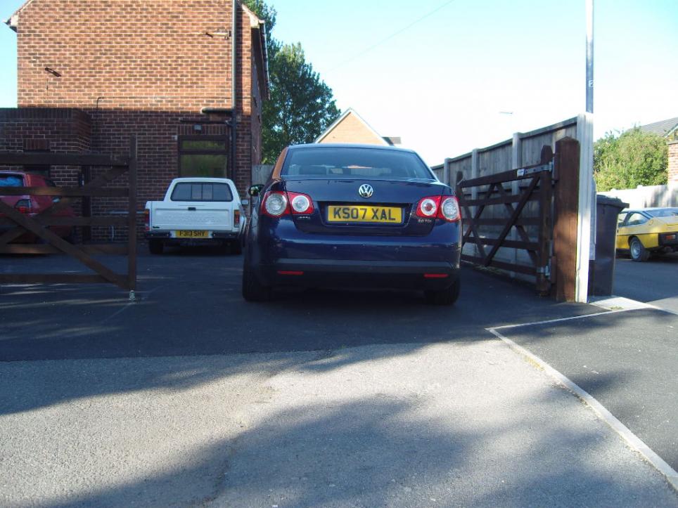

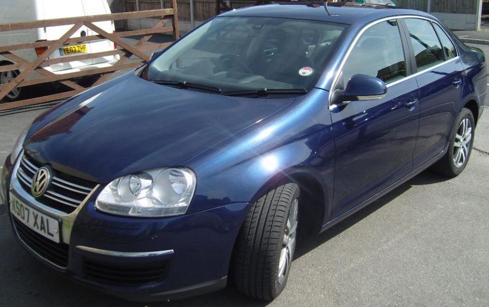

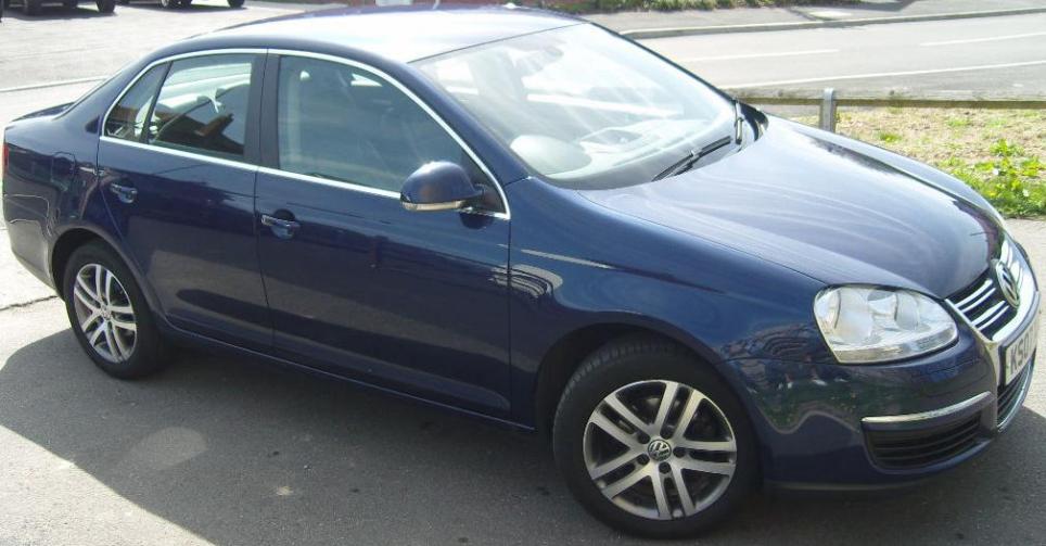

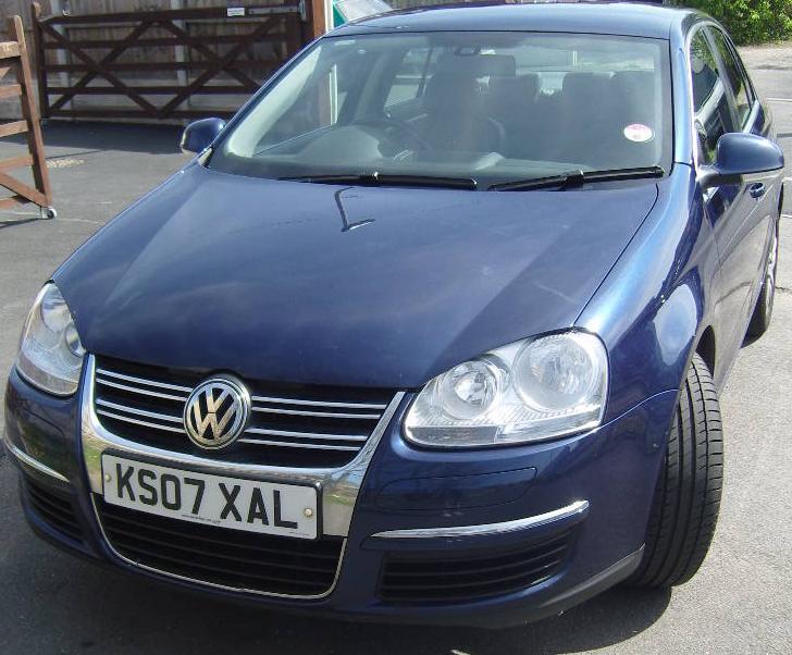

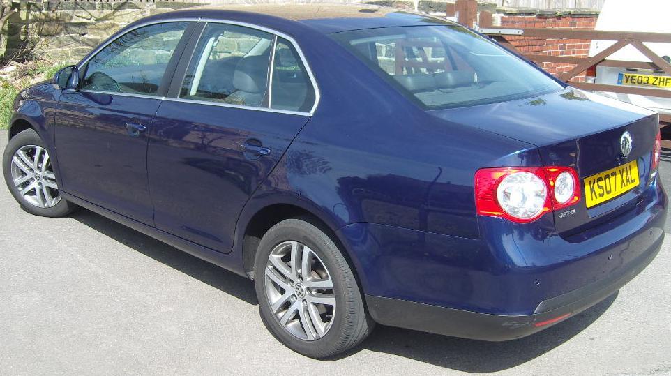

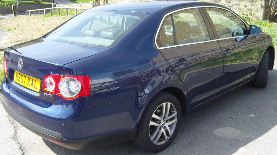

    Here are some pics of it when I got it:

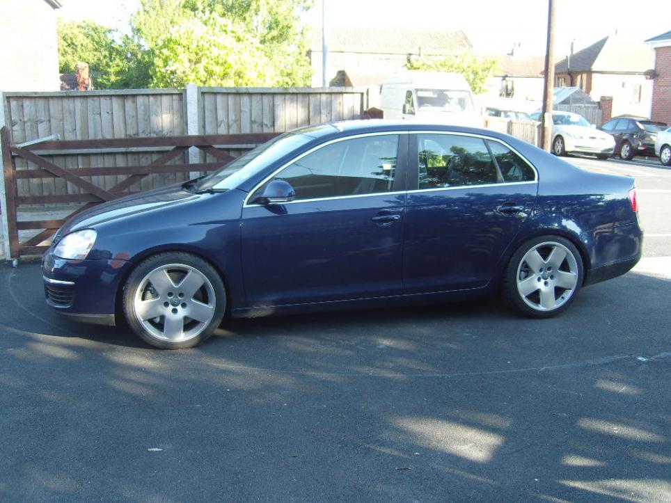

    First up is the chassis -

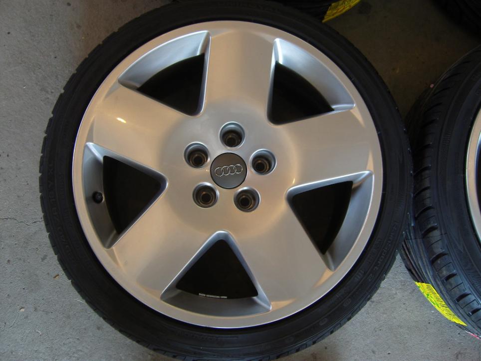

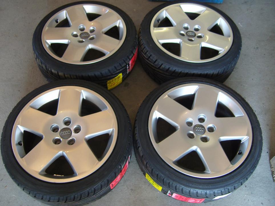

    Audi 18" x 8.5" Fat Fives with 225/40/18 Uniroyal Rainsports

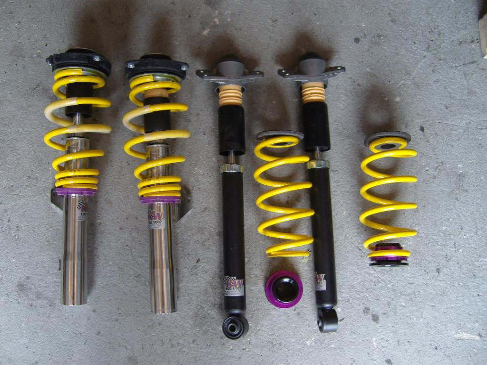

    KW V1 Inoxline
    We also fitted an Audi TT 2.0 TFSI Rear Axle and Alloy Hubs that gave us 26mm more width and TT Front Alloy Hubs and Cast Wishbones, which give an extra 30mm and more camber. I have loads of pics, but didn't upload them. Everything is much beefier and lighter.

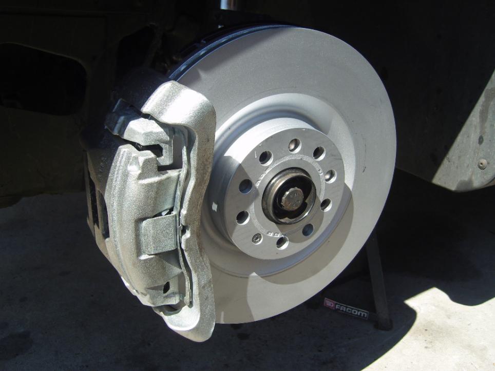

    R32 345mm Front and 310mm Rear Discs. The front calipers have a TyrolSport Caliper Stiffening kit, which I would recommend it to anyone. Google it and see what I mean.

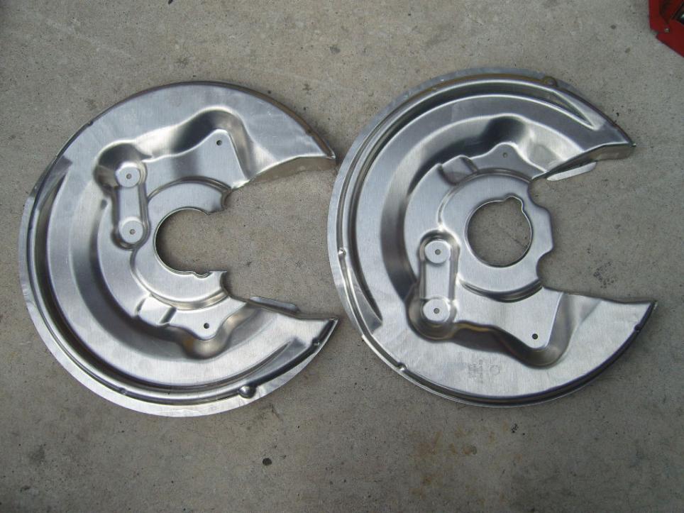

    We used Eos 3.2 FWD Splash Guards with fit perfectly with a slight modification

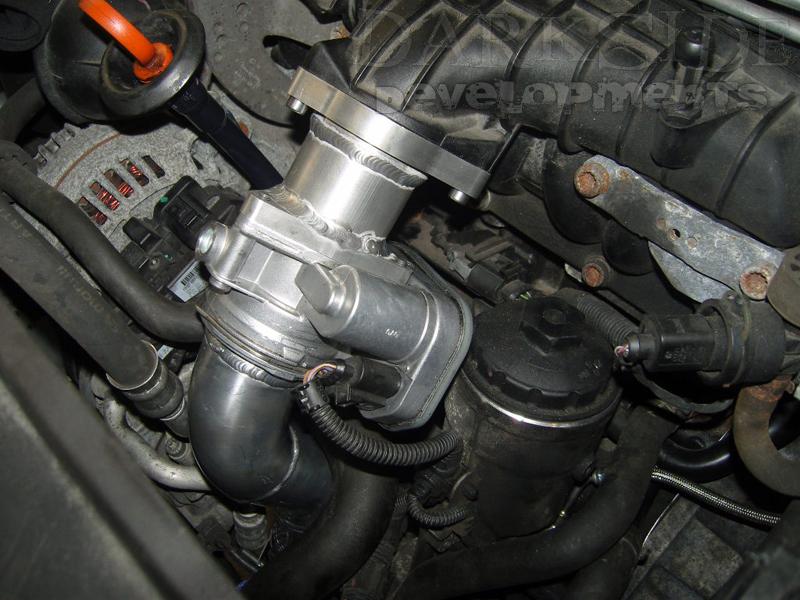

    We then fitted a Darkside Developments EGR Delete and removed the EGR cooler completely:

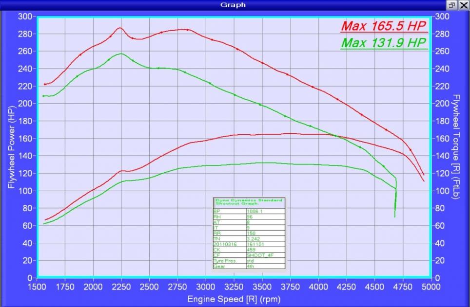

    After we mapped it and took it to the dyno, here were the results:

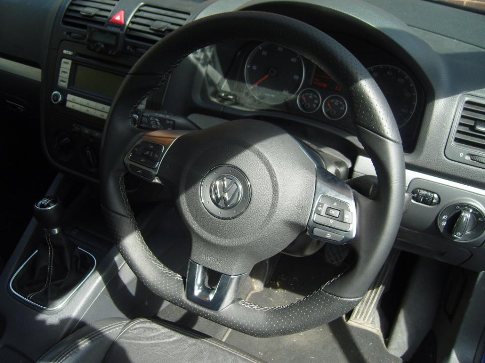

    Some little interior mods -

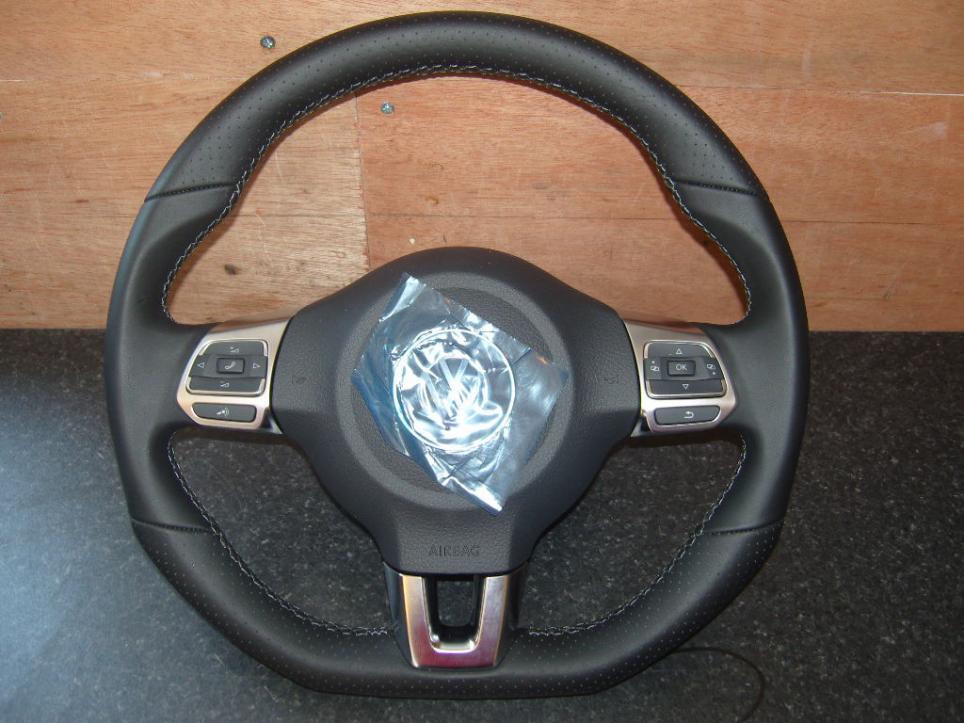

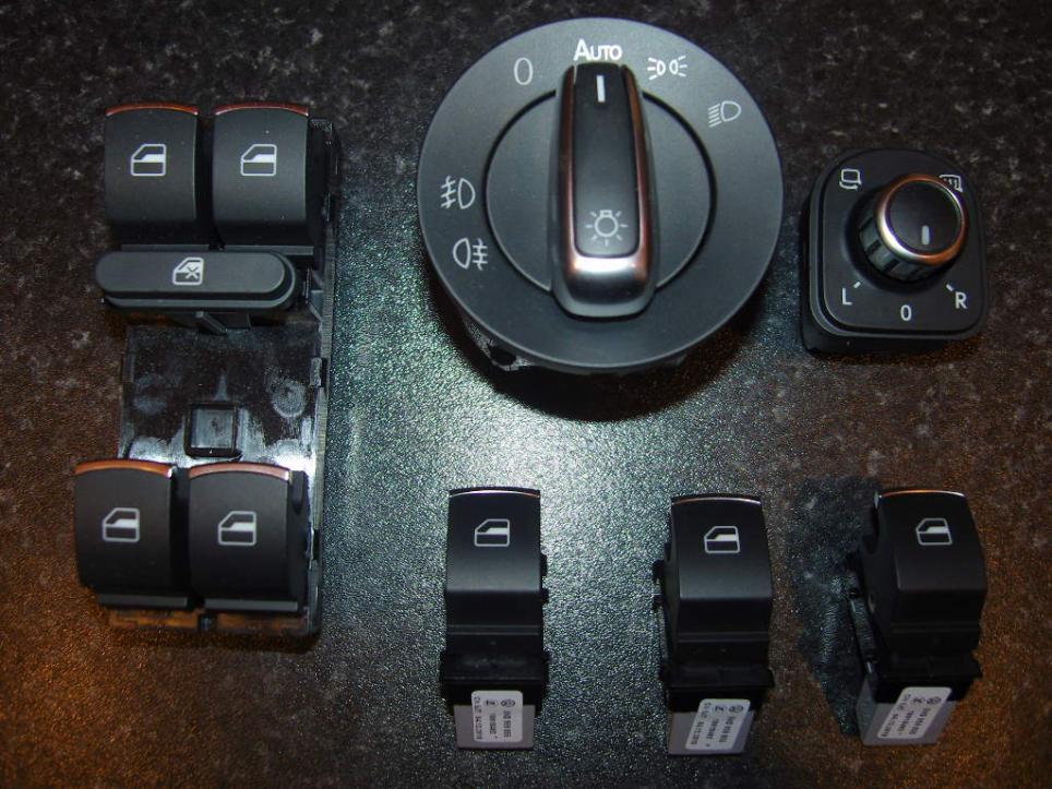

    Scirocco Flat Bottom MFSW
    Passatt CC Switches

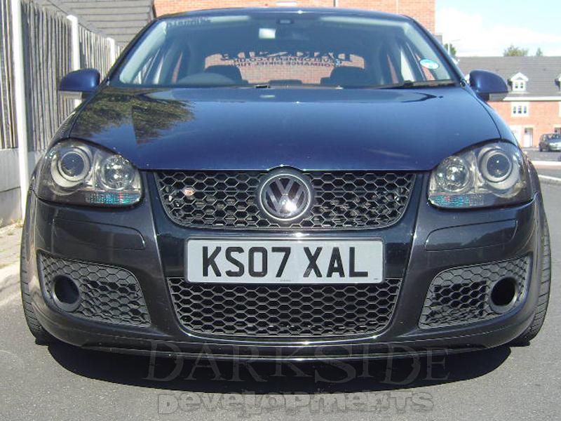

      Golf GTi Front bumper with Summer grills
      Jetta GLI Rear Valance

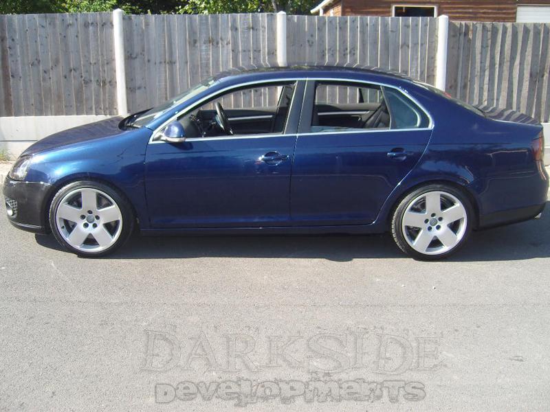

      Here is how it looked:

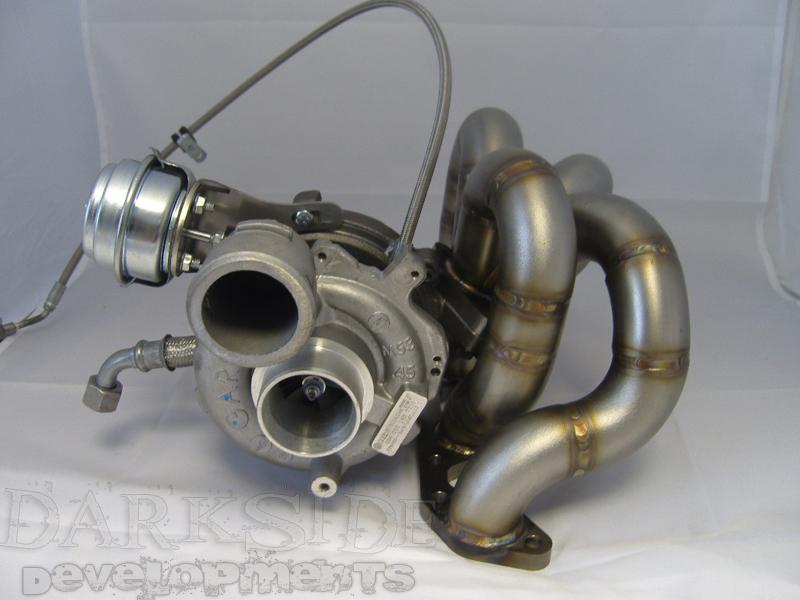

      Next was to fit the Darkside Developments 2.0 16v TDI Turbo kit with a GTB2260VK Turbo from a 3.0 v6 Audi:

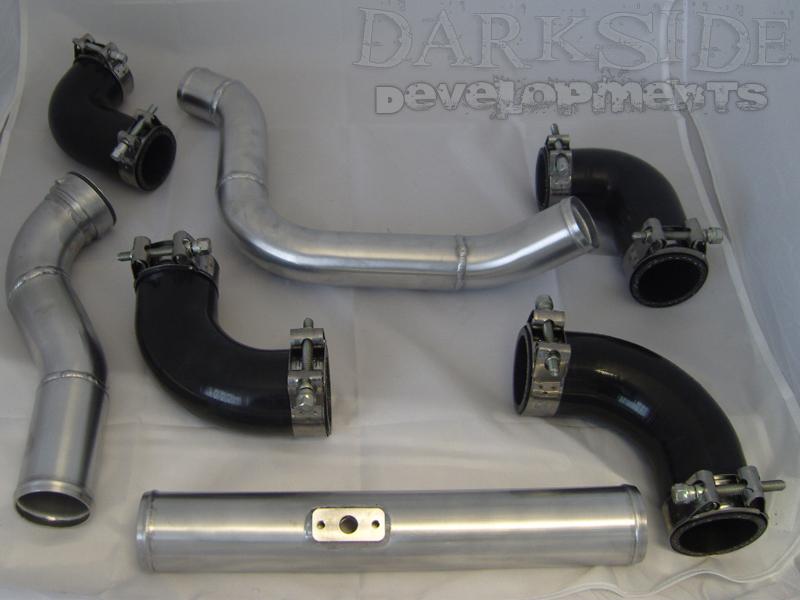

      Along with an S3 Intercooler and hard pipe kit (I didn't get a pic of the cooler before we fitted it, but it is all alloy with welded end tanks and no clip connectors):

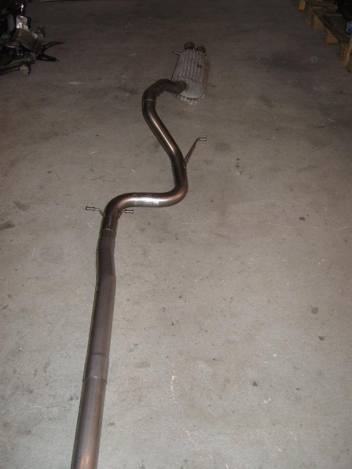

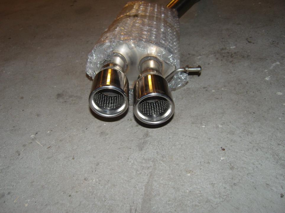

      Milltek 3" System (made for a US Jetta GLI):

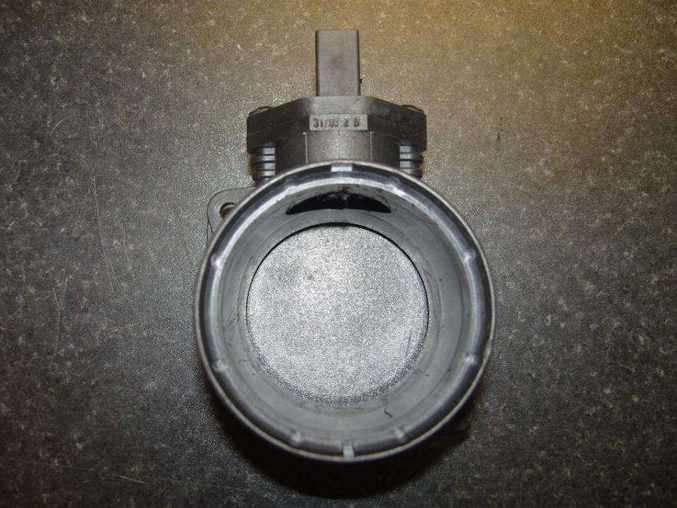

      We also modified the MAF, as it was deleted from the map:

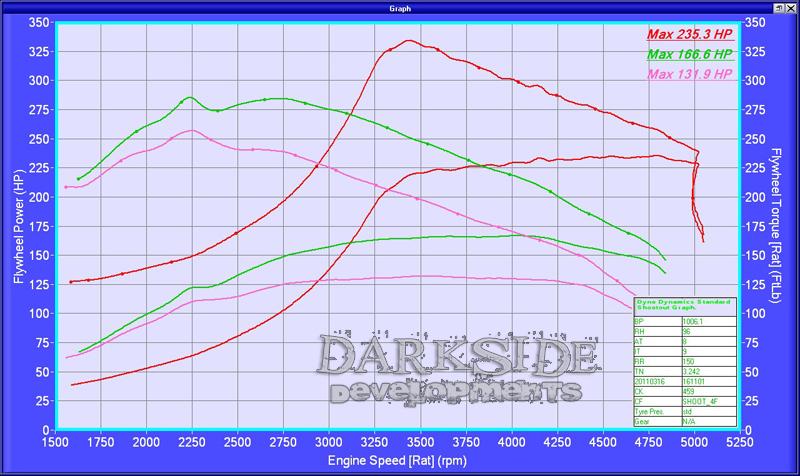

      Then we took it to the same dyno so see what we were making
      235.3BHP and 330Ft/Lbs. This is on a very conservative dyno (the operator calls it the 'heartbreaker') with ZERO smoke and a very road friendly tune. 3 days after fitting the turbo I drove 1500 miles to, from and around Cornwall and averaged 57mpg for the whole trip. It didn't skip a beat.
      We still have some adjustment in the stop screw to get the boost to come in a little earlier, but it still pulls very well from low RPMs. What you lose at the bottom end is nothing compared to what you gain at the top end, it pulls like crazy to the 5000rpm fuel cut we have in the tune and pulls 130mph in 5th easily. I have found the 140mph electronic limit though, which we are working on removing ASAP!

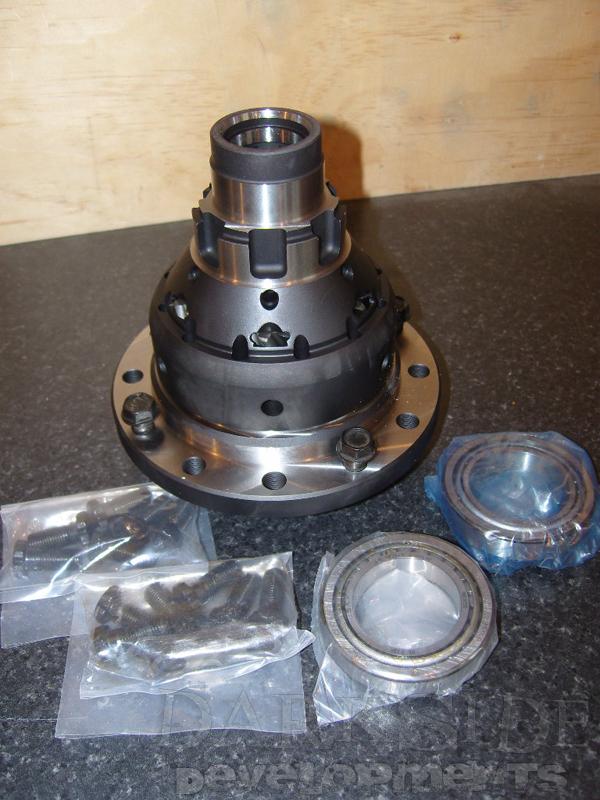

        Next on the agenda are a Sachs SRE Single Mass Flywheel and Sintered Paddle Clutch, Peloquin Limited Slip Differential, fitted to a low mileage PD170 Long Ratio Gearbox

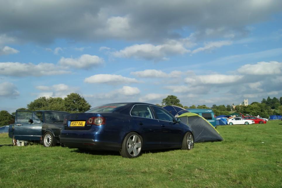

        Someone on the Edition 38 forum posted up a pic of the Jetta at their show:

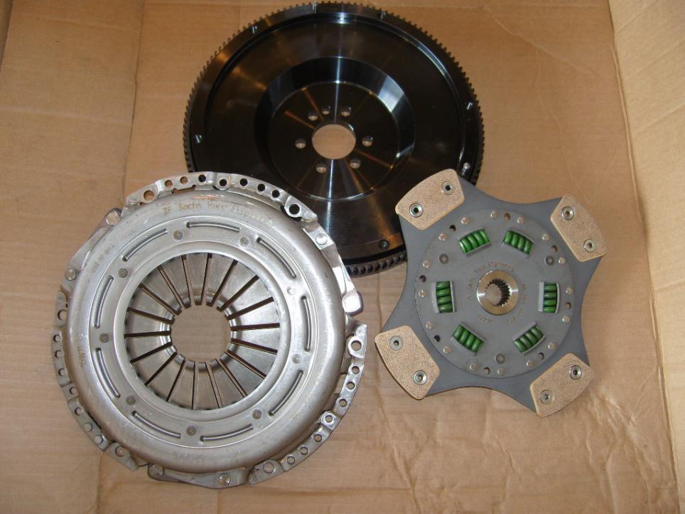

        We then fitted the Sachs SRE Single Mass Flywheel and Clutch and a PD170 Long Ratio Gearbox with a Peloquin LSD Installed. We also strengthened the shifter forks so we can do some fast changes. Once the clutch was run in, a set of Race PD Injectors was dropped in.

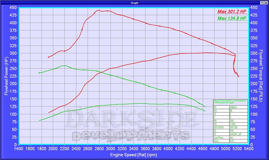

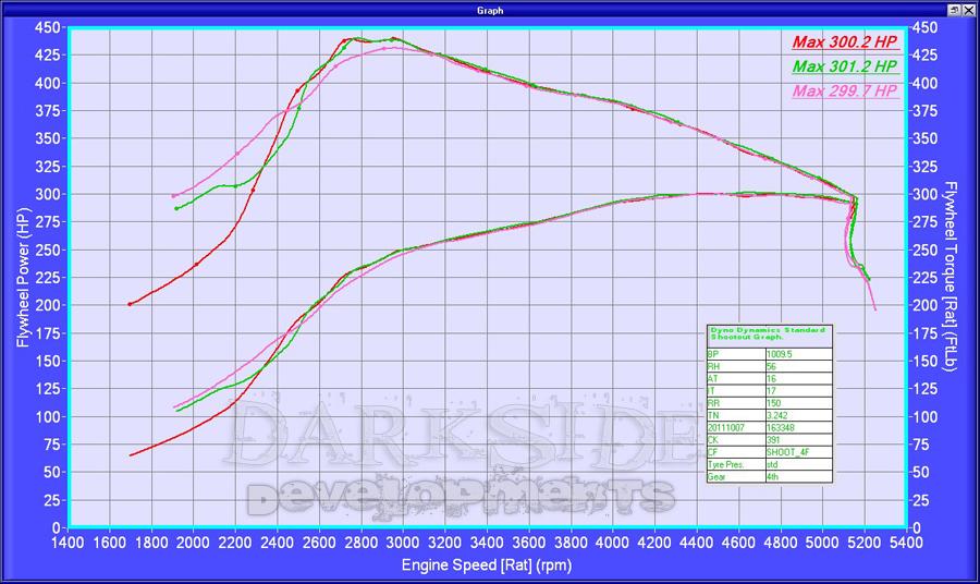

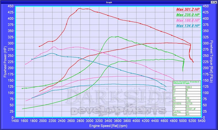

        Here are the results from this afternoon:
        We did 3 pulls and they were all pretty close together, the best run was 301hp and 440Ft/Lbs.
        And here is a graph comparing the stock power to now, we have made pretty good progress!

        Darkside GTB2260Vk Turbo Kit with Tubular Manifold and 3" Downpipe

        Milltek 3" Non-Resonated Exhaust System with Twin 76mm Jet Silencer

        301BHP & 440Ft/Lbs – Dyno Proven

        Sachs SRE Single Mass Flywheel with Sintered Paddle Clutch

        KW V1 Inox Coilovers
