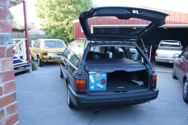

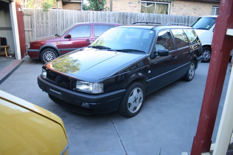

    baaahhh!!! my Gwagen has arrived!
    its a motronic 2.0lt 16v auto (best) and comes with all the creature comforts, except sunroof (not best) BUT drives cool az, a few stone chips and 1 big graze under the rear drivers light, but nothing dad and i cant fix.......
    interiors immaculate! AND CHECK OUT THOSE RAD JAP SPEC FLOOR MATS!!!!
    some of you may know why i put up the experience on air bags thread but for people who didnt know why..... this is it!
    its going to get full custom airbag suspension and a set of 17's tucking...
    itll be a quick project and hopefully have it done by SEDF
    some pics fo you all

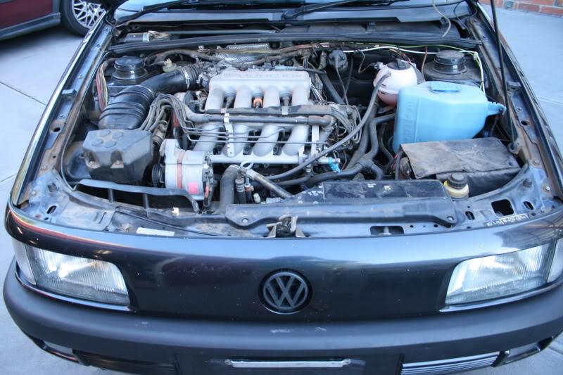

                      Not much you can do in a K-jet tune on these Dom. I have the KE-motronic VW manual somewhere in the garage. Let me know if you want it to take a copy.
                      Have a look at the rear bush in the front wishbones. I'd be surprised if they don't need doing.
                      I have had loads of these wagons, including a G60, 9A, 2Es and 2 1.8GTs. Australia missed out on a really good/useful car with these.
                      Cheers
                      Gavin
                        didn't dom say that this one is monotronic? it doesn't look like any Kjet setup i've seen before? (lack of metering head???)
                          They have a metering head Jarred, it's on the left side of the engine bay photos, with plastic cover on it. Just behind the headlight.
                          The thing with this version is that it has lambda control and can be chipped unlike the KR engines. There is block on the side of the metering head that controls fuel pressure and therefore mixture. It also has knock sensing.
