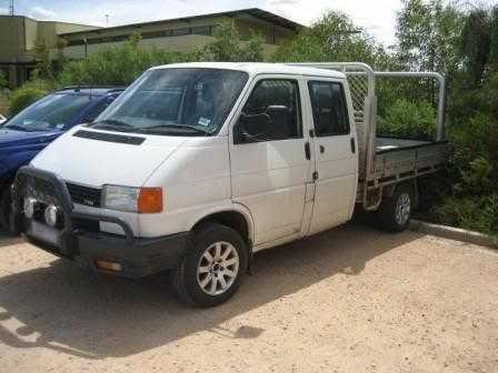

    I think Seano had some info, and I think the Bocar was the main one. It was, I believe, the one fitted to the NSW Ambulance T4s.
    Maris
      Yep. It's a Bocar bar.
      Likes:
      it's a bumper replacement bar
      reasonably tidy (not too ugly)
      Dislikes:
      installation manual is awful
      fitment requires drilling out a couple of existing chassis holes to 13mm
      fitment requires removal of tie down eye on drivers side
      bar is made of multiple parts bolted together so perhaps not as strong
      gaping hole in centre loop which would fit big lights but also big roo
      limited finish choices from factory
      Modifications:
      Alloy security mesh welded to upper half of centre loop
      powdercoated in Dulux charcoal and Dulux clearcoat
      What I'd do next time:
      Buy the spotties with the bar & have a mounting bar & tags welded in to the correct height within the centre loop
      supervise the powdercoating job myself rather than letting the agent organise it
      After five years in-situ:
      It has never been tested....
