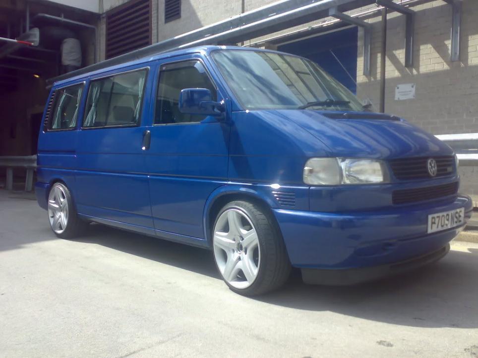

                Thanks Guys for all your info, Bug Racer has a set of springs that i have bought, so hopefully in a few weeks i'll have a van sitting a little lower to the ground. Then its time for a new set of wheels. Has anybody got a set or know of a set of 17" 5 spoke Bora wheels for sale? Also curious of the load rating on them? just for insurance purposes. I'm hoping being factory wheels there rating is heavier than a lot of the aftermarket wheels available.
                  Would Bora wheels fit?
                  They dont in the UK
                  Thought they were 110x5 pcd and the T4 is 112x5 pcd.
                  Audi, Bentley, Merc wheels are the same pcd
                  Bentley wheels on my Caravelle.
                  Audi wheels on my caravelle
