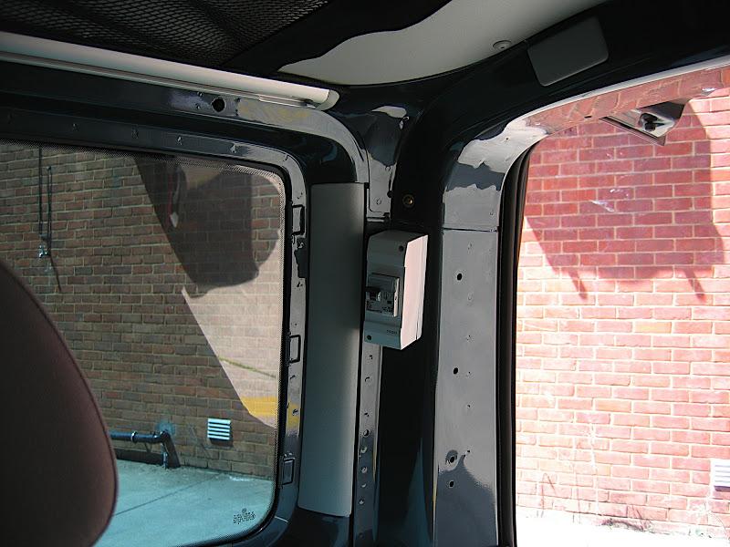

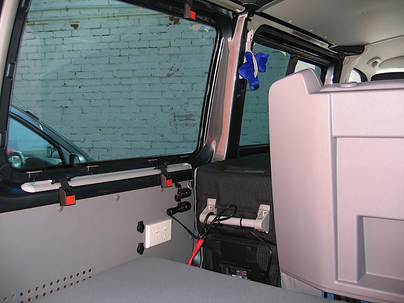

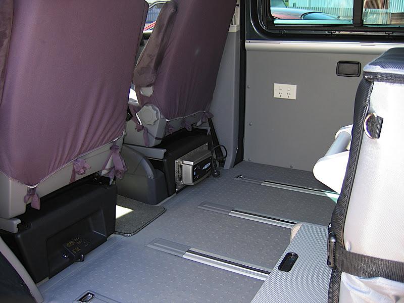

    finally got my 12v and 240v sorted out (except for an inverter) Had 240v inlet added with 2 power locations and have got the fridge running on 12v all the time, (well when there is Beer in there ) had the MAG Code socket replaced with a hella plug, a charger to charge 2nd battery at 240v locations and a low battery cutout, pretty happy, the installers put 12v plugs in wrong spot for fridge though (they put the 12v where the 240v was supposed to go) cause the storage bags were hitting them, kept them there and got them to add a couple more side entry plugs (no charge).
    don't ask how much to install the 240v was quoted 3 times less!:

      The hooks I used for the small saddle bag are plastic hooks from Big W camping section connected to two of the original ones that came with the van for the saddlebags. If you pull the pin out from the back you can remove the original fitting and then feed it through the new hooks. I moved this bag because it loses a bit of the bed width, whereas the big one is on the side where the fridge juts in.
      Your 240V looks ok, its a bit of a job isn't it. I have moved my drivers side socket 80mm to the left of where my pics show it so it is in between my solar cells and small saddle bag.
      I used my mains battery charger now and then over the 4 days, to top up the battery, even though the fridge was running on mains as it has auto switch over, all the lights run on 12V so slight drain on battery.
