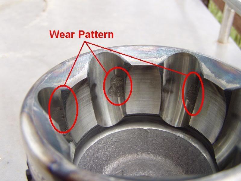

I noticed a small amount of grease on the underside of the lower ball joint nut & on one of the ribs of the CV joint boot, time to get out the tools.
This procedure is for a LHS CV joint /boot replacement on a 2001 T4 with auto. trans,-- RHS & manual trans. is very similar.

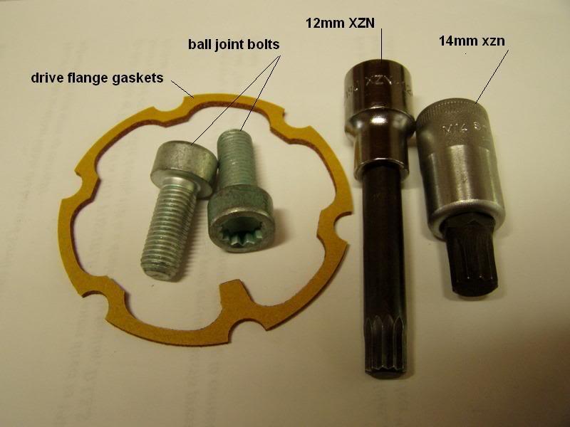

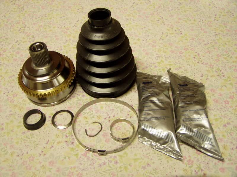

Photo1 These are the parts that come in the kit for replacing complete joint.GKN Lobro, same as original.[approx. $140] The boot kit is the same minus the CV joint. [approx. $20] Not shown but included in kit is a new stretchbolt.
These are the special tools you will need & sealing washer 8D0 407 309A $6.40.
2 new stretch bolts for lower ball joint VN104 09602 Approx. $1.60 ea. Note. The stretch bolts & 14mm XZN won't be needed if you choose alternate method. [see below]

Loosen all the screws connecting the inner CV joint onto the trans. drive flange using 12mm XZN key while the brakes are still available to hold the assy from turning.I noticed in ETKA that some models use larger screws [M12 instead of M10 on my model] If yours is one of those you will need a corresponding larger tool , probably 14 XZN.

Remove the 2 socket hd, cap screws holding the lower ball joint onto the lower wishbone with M14 XZN [triple square] key. It is possible to leave these screws in & remove the nut underthe balljoint but you will need a special puller to remove & reinstall from lower wishbone.

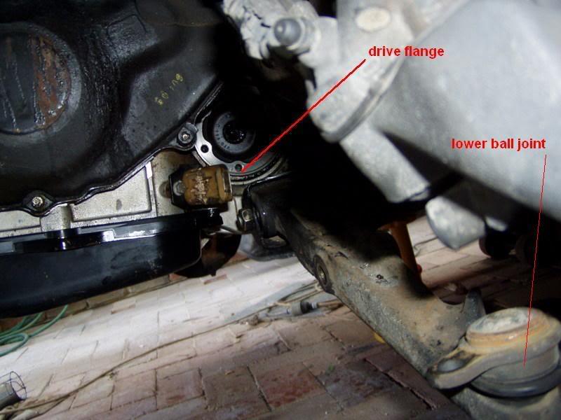

Remove the screws from the drive flange with your 12mm XZN key [they don't need to be removed completely]
If yours is an auto you will need to remove elect plug from multi-function switch. [press in ears to release & pull out]
VW says on the auto.you need to remove the "pendulum support" from gearbox & move engine/gearbox assy. forward to remove driveshaft. I did this on removal but found if you lift the steering assy high enough, you don't need to do that. The part of the assy that interferes is the cap on the inner CV joint.

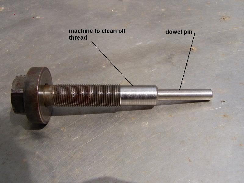

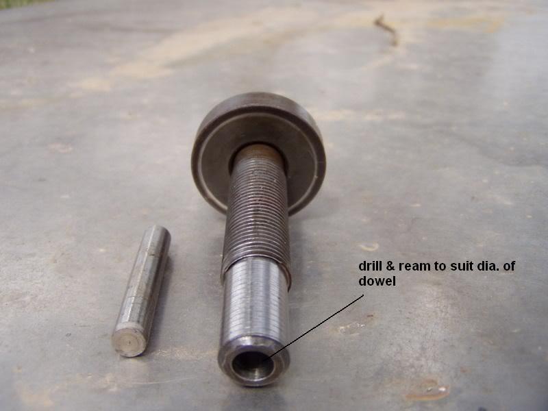

VW use a special tool but I made one from the screw that I had removed. The tapped hole in the CV joint is slightly tapered & the original bolt is not long enough so a couple of mods are needed.
The screw is inserted into the joint & applies pressure to the end of the shaft. The circlip is forced into the groove on the shaft allowing the joint to come away.

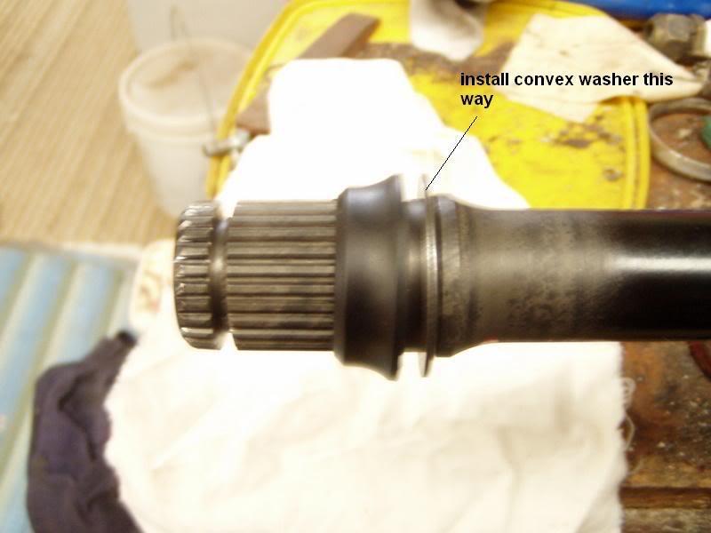

Make a note how the convex washer & plastic spacer is positioned on the shaft. Remove boot & wash every thing clean. [use paper towels/rag & solvent,very messy]

Assy is in this sequence. Inner clamp, boot, dished washer, plastic thrust washer, circlip,CV joint & large clamp.

Clean drive flange in gearbox.
With the upper track control arm as high as possible & brake disc blocked up, insert shaft into position & retying outer end with a cord or wire.
Loosely screw in cap screws to drive flange.
