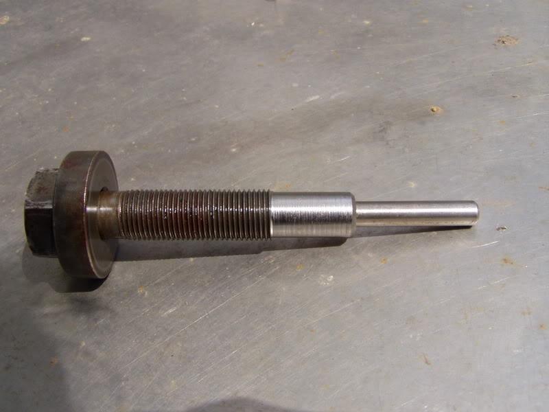

        On the T4, the CV joint is removed be screwing a special screw in the end of the shaft. As the orig. bolt is a stretch bolt & is replaced anyway I reworked mine by turning the thread away at the end so the screw will go in far enough. The tapped hole in the joint seems to be tapered & the screw just tightens up. While I had the screw in the lathe I drilled & reamed a hole in the end to take a dowel pin that I had. The end of the pin sits in the centre drilled hole in the end of the shaft.
        A couple of other points on this job is to not put the weight of the van on the wheels after the bolt has been loosened/removed. Purchase new gaskets that go between inner joint & drive flange. If you removed lower ball joint, replace stretch bolts.
        I am intending to do a write up on this procedure with pics in the near future.

          Heres a pic om my modified jacking screw.

            Nice drift! There is a special tool for that job that screws onto the hub with the wheel bolts, then the centre screws in and pushes out the shaft.
            Cant remember from the top of my head the part number but i do have it some where. Im sure they would be made now as an aftermarket item. The MK3 golfs when they were newer were shocking to get off and u used this tool. There was loctite on the splines on them.
            Still i like that drift woulnt mind getting one of them, how much to get that done mate?
            Alba European
              This tool only removes the CV joint from the shaft, it doesn't push the shaft from the hub. This tool will only work on the T4 [ I think]. Does the mk3 have same design as a mk1 where a nut is used to clamp the axle to the hub?

                Thanks guys for the update.
                I ended up looking up on 20v.org where they had a detailed how-to invoving using the bolt to jack the joint off.
                Worked a treat.
