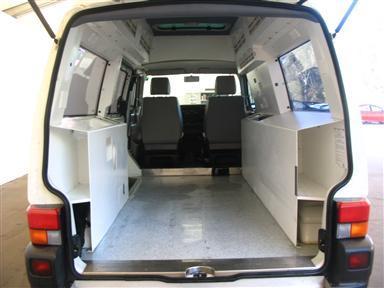

    Its a 8/2002 ex ambo, yet to collect it, will do in a week or so, has everything, dual air, turbo, cruize control, eleky windows, ABs etc, and upgraded suspention, it is 2wd, 2.5tdi.
    so you tassie guys will see me out and about in tassie for sure, soon will be sign written.
    Andy

            looks like you can drive a car into the back of it
