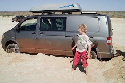

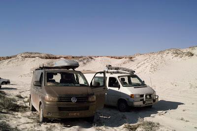

Had 6 weeks in WA recently with lots of sand driving. T5GP 132kw DSG LWB 4Motion Diff Lock
My first experience is an exercise in what not to do! --> I had driven over from Vic with nitrogen in my tyres and a pressure of 49psi. When I got to the beach in Exmouth/Ningaloo (Neds?) there was a 4WD out on the beach. I drove out towards him and quickly realised that I was about to get bogged so I stopped. I should have let my tyres down earlier but didn't want to lose the nitrogen. This is apparently a notoriously soft sand beach / river mouth and there were a few raised eyebrows and concerns from people in the area!
I got out and let the tyres down to about 28psi thinking that that would be enough. It was still struggling. As this was my first Auto in the sand i wasn't sure what to do with the traction control button. I had already engaged the diff locks, so I disengaged the TCS and ended up digging an even bigger hole for myself! Finally I let the tyres down to 16-18 but by this time I was "down to the axles" and stuck.
Luckily there was a 4WD nearby (how convenient a place to get bogged) and he snatched me out.
Subsequent episodes on the sand were approached with caution, but eventually I gained confidence in the beast.
Depending on the sand tyres need to be 16-28 psi.
Diff lock obviously helps somewhat.
Leaving the TCS on I found works better.
For tricky stuff -ie sand hills / tight corners --> best gear was 1st in manual mode.
For easy stuff then sports mode was fine.

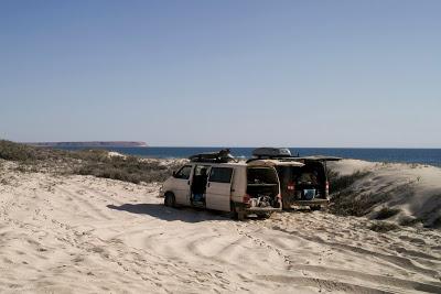

In the background is turbo diesel 2.5 L Syncro, not sure what year. He has bigger tyres - 225/70/15. It does amazingly well in the sand with tyre pressures low.Originally posted by vannin View PostHow did the T4 in the back ground go? Im keen to give mine a test but coming from a 4x4 background Im not sure what to expect.
