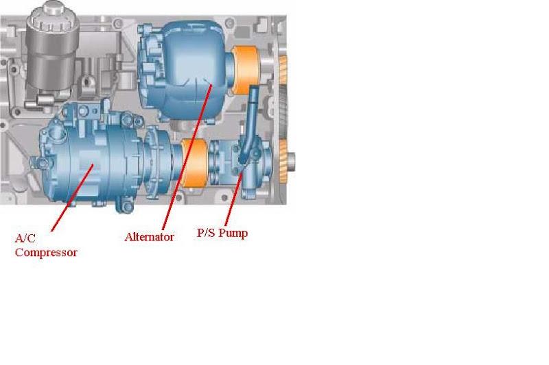

The elastic drive couplings are replaced at 150,000km.

I would also consider replacing the rachet hubs which connect with the gates couplings if this is not already part of the service, from what I have seen, the gates couplings would last forever, but I have already had a siezed hub which I suspect destroyed my air-com compressor.

Check your handbook. On mine (2007 128Kw) these are recommended for change at 180k, but I think earlier models may be earlier (even earlier than 150k I thought, but I could be wrong).Originally posted by Transporter View PostThe elastic drive couplings are replaced at 150,000km.
