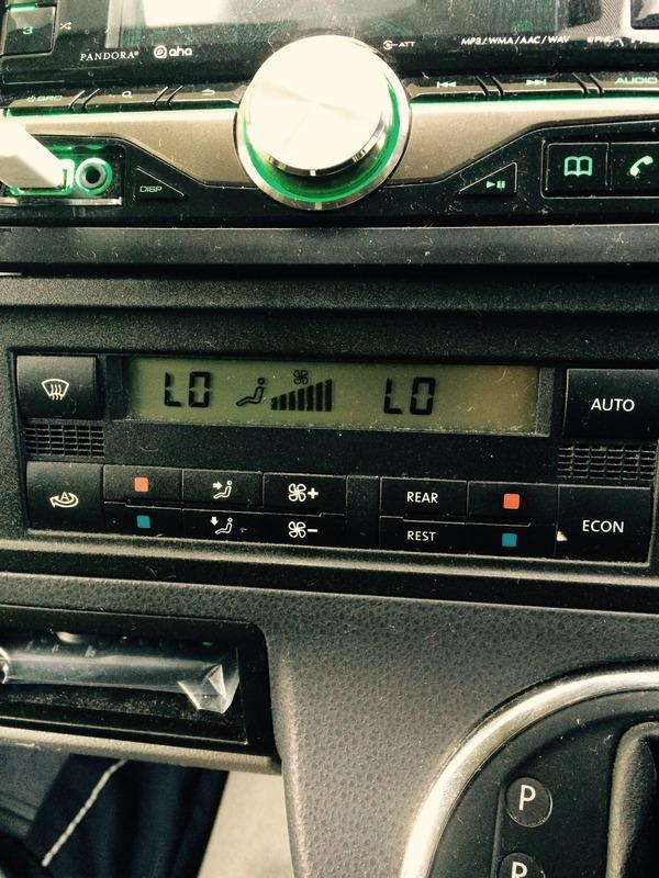

                            No A/c switch
                            Thanks
