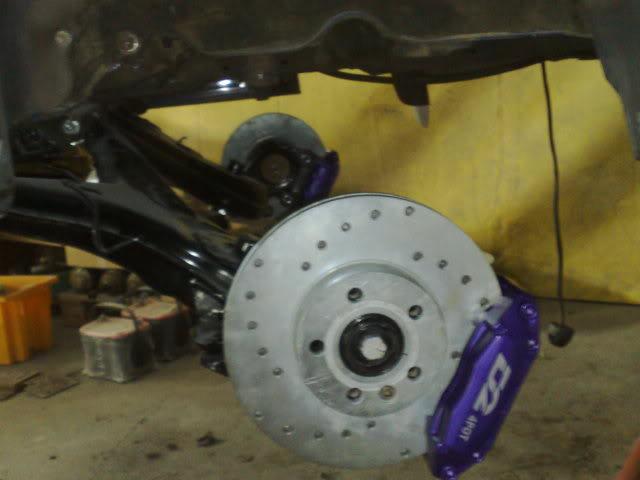

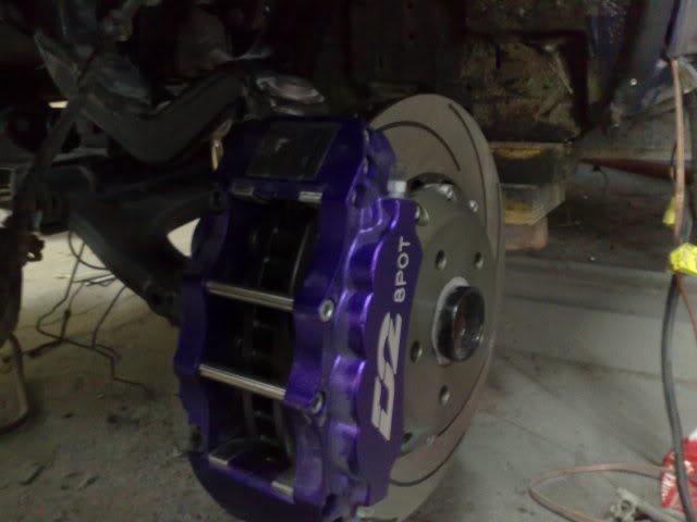

        At least for T4 there's a D2 kit available for front and rear, but I made rear from parts already laying in my garage.
        Front D2 330mm, 8 pot.
        T5 front discs (drilled holes to them for looks) and Brembo 4 pot calipers (front calipers from Seat 1,8T Cupra) painted to match for rear. Homemade bracket. Needs hydraulic handbrake.

          That is serious stopping power at the front (you needed with that power output), are these ATE slotted rotors?
              No that's a complete set from D2 with even braided brake lines included... Would have prefer slotted discs for rear too, but drilling was easy / cheap.
