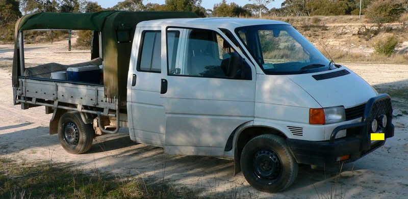

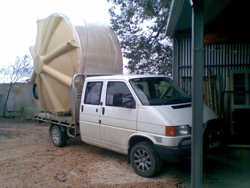

              Not a van....that would far too impractical for yours truly.
                Thank for that is that with the tyre and lift you described? Looks good!
                Nik
                  Latter photo was taken nearly four years ago. Tyres are stock 205/65R15's (its still wearing those boots now, four years later) . So no lift there. And the suspension lift was three years old by the time this image was taken....which included a partial Australian circumnavigation and full time on rough far western NSW unsealed roads. So it had sagged a bit...
