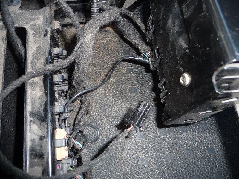

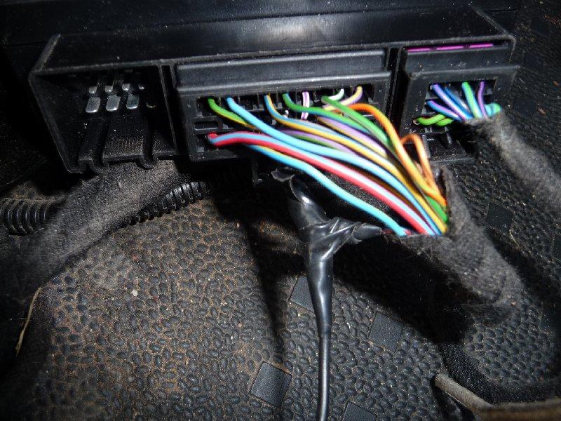

                    Thread dredge
                    Same fault again,passenger door had intermittent unlocks,eventually wouldn't open at all.
                    Removed drivers seat and resoldered 3-wire connection (blue/ red stripe to black) near control unit.
                    Eventually got door to unlock but was very noisy in operation.
                    Decided to remove door lock and lube.This involved removing the door trim and internal carrier
                    All good again
