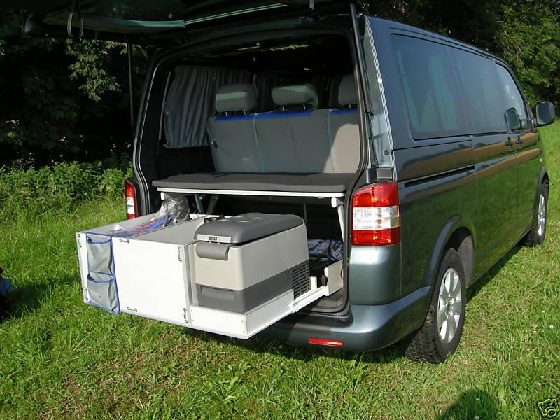

              Has anyone seen a similar slide-in kitchen at the back of a Multivan like this one:
              I think slide-in unit is a great idea as I don't want to have permanent structure inside the van, so that I can use the van as a family vehicle during the week. When I go on a trip then just slide in the kitchen unit and use it as a camper. The top of the drawers can be used as sleeping surface during the night.
              I like the idea of cooking outside of the van. It means less smell and less damage to the interior. I find cooking the major cause of aging for the van's interior.
              I am also asking Brett if he can build or ship one like this for me. If I get my pop-top/roof bed, a slide in kitchen unit, and 2 swivel base of the front seats, my dual-use family van/camper dream can come true. (perhaps I will need another battery as well)

                  Jackie,
                  Not as good as your find but a simple idea to get you going with the kitchen...

                    Thanks Brian. The boxed kitchen seems quite heavy to take out and set up. I have a bad back so I prefer slide out drawers with a small camp table and cheap gas stove.
                    Rob, I like your photo, is this used to be your van? Did you build it yourself or you saw it on the net? It's brilliant and simple. I can just add a small camp table and start cooking. Is it a slide in unit? the drawers seem to be able to take a lot of weight.
