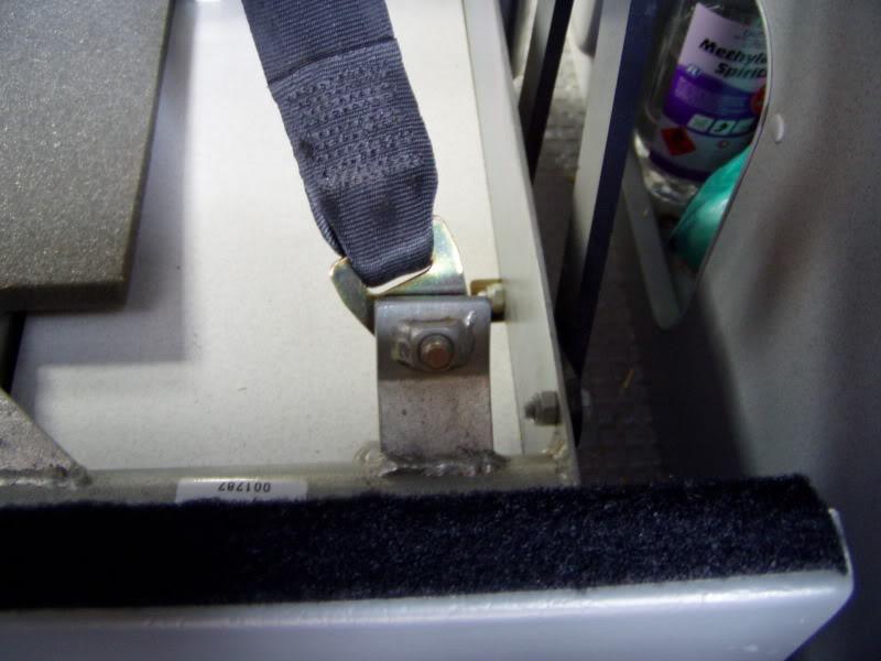

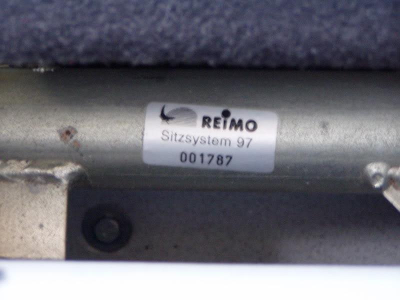

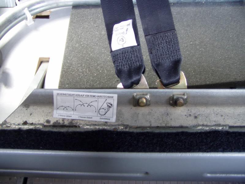

Do you not have to have seat belts in the rear of your vehicles in OZ?
One of the reasons i ask this is,
The Variotech seat this van has in it can not be fitted with seat belts.
And the vehicle used is a transporter/van so did not have the seat belt mounting points fitted at the factory.
Only the caravelle or the long nose van versions (same front as later caravelle) had them fitted.
Thanks Rob

) so I kinda stand by my original assertion that you don't waste money on multiple dies for commonly shared infrastructure (nor on fitting captive nuts, not to mention entire double skin pressings) if you can avoid it. And the missing captive nuts surprises me not a lot because a mate who works in the auto manufacturing industry reckons they go over vehicles with a fine tooth comb and if they can shave costs by 5c a car they will!
