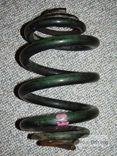

        Originally posted by Bianco View Post
        So its OK to fit lowering springs and keep the standard shocks?
        Yes. From stock (white or blue marked springs) to 40 cm lower springs -> no problem. The shocks can still be used.
        Some additional information can be found at my website. Unfortunately available in english through the google-translator only:
        gaskutsche.de - Infos rund um den VW Bus, Flüssiggas als Kraftstoffalternative sowie Tipps, Tricks und Basteleien für den T4
        Where to find the color: Like on this one, the pink spot -> standard VW marking.
