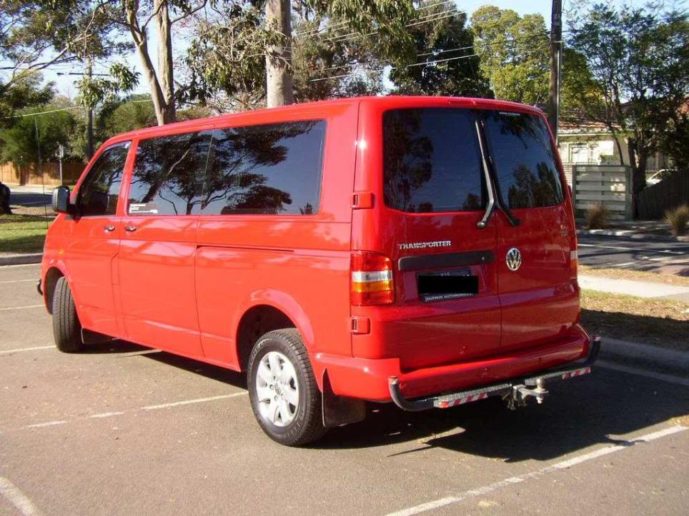

                    If you don't have factory installed reverse parking sensors then I'd go the H-R option. I have one on my van with a step and rear protection bars, 250 tow ball weight and 2500kg tow rating although I'd never tow that much. I should have had the factory wiring loom dealer fitted to automatically deactive the rear sensors when a trailer is installed however they installed a round pin which doesn't have an internal switch to send a signal that a trailer socket has been connected. Dealer fitted a seperate switch for me to turn off the rear sensors. I do have ESP and haven't heard about this mentioned when talking tow bars and the factory wiring loom. It may have a bearing on the ESP calibration although I thought I read that this feature (an ESP setup which catered for towing) was a T5 update feature..

                        Hi Tornado
                        Nice looking van! I think the cow horn bumper protection was included in the price i've been quoted, but not sure about the step - which would be very useful.
                        I'll have to ask the installer.
                        David
                          I was told that "pork pie" when I was shopping for a hitch receiver for my T5.

                            The hitch is modified by Vehquip, Ferntree Gully Vic, who add the horns and step to a H-R supplied unit. Burwin's VW use this supplier for many dealer fitted options to T5's and in fact I ordered about $6K of options directly with Vehquip and had the dealer settle with them so that I had one pick-up and inclusive finance deal. Their quote for the tow bar back in '07 was under $800 fitted.
