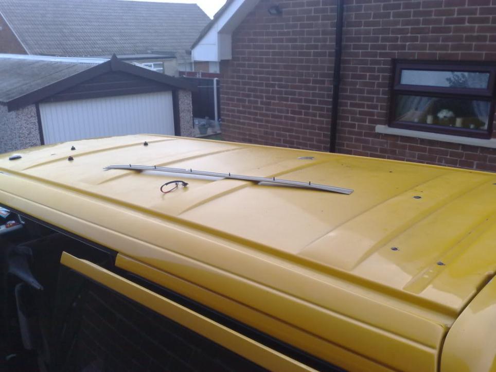

    Nice clean shiny van to start with..

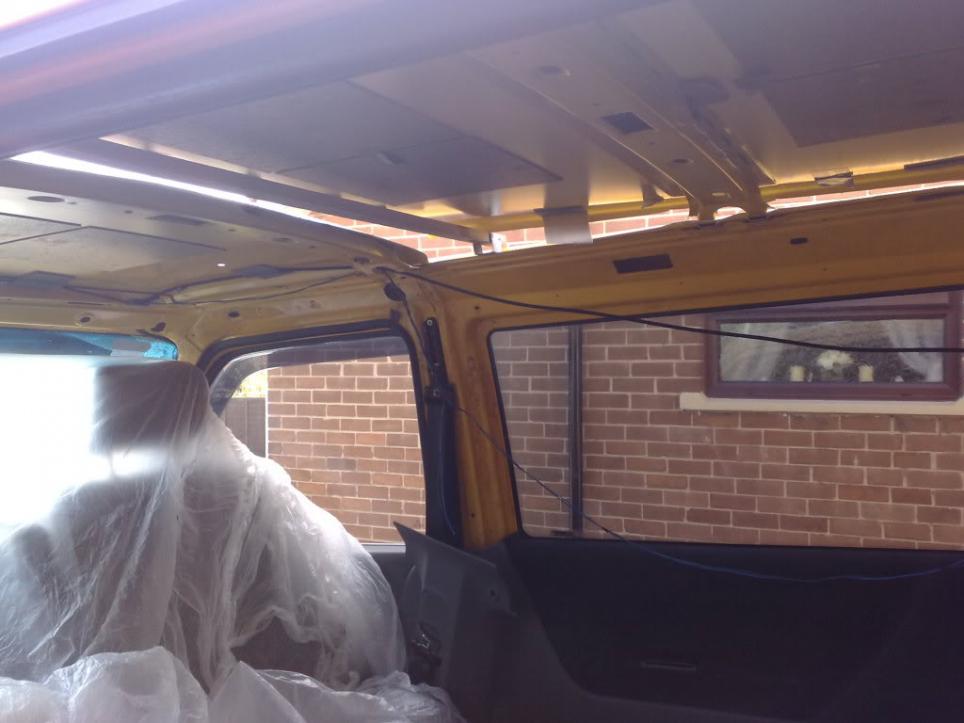

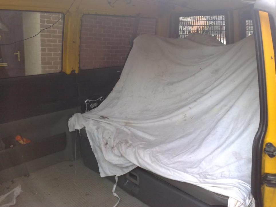

    Then you have to remove the inside panels and cover any thing thats left..

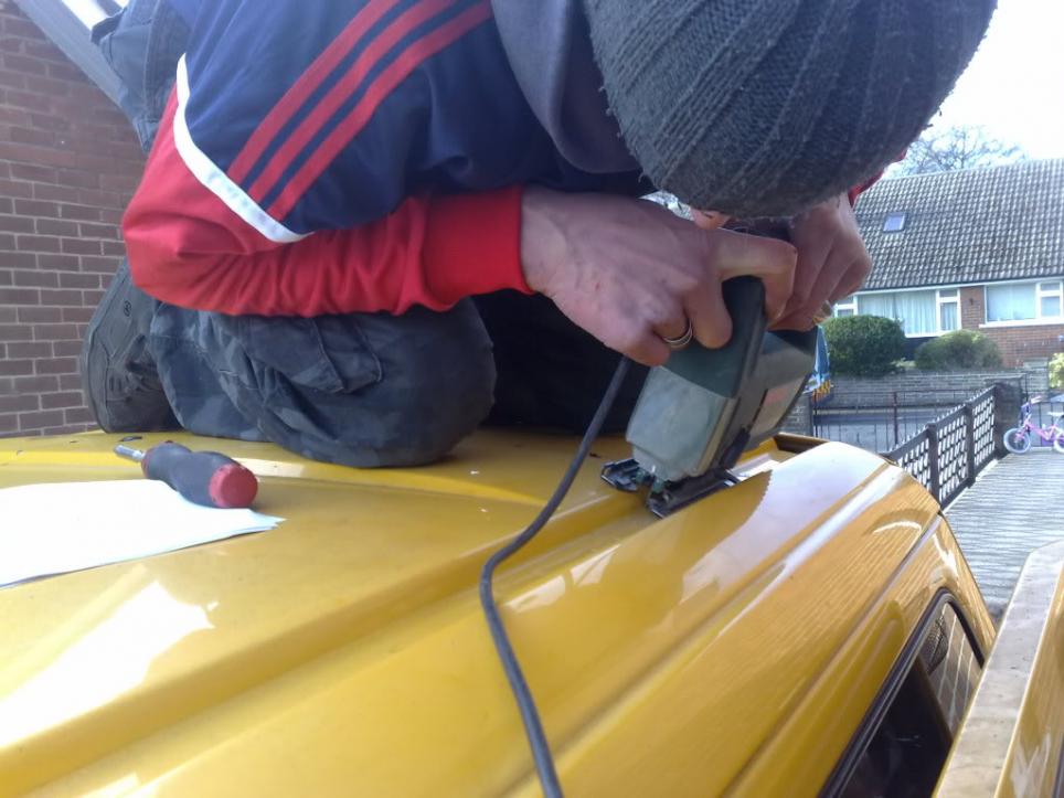

    After some marking out you have to make the first cut(big narnas needed at this point)
    No going back now Jim(little jim watching her new bed room being made!)

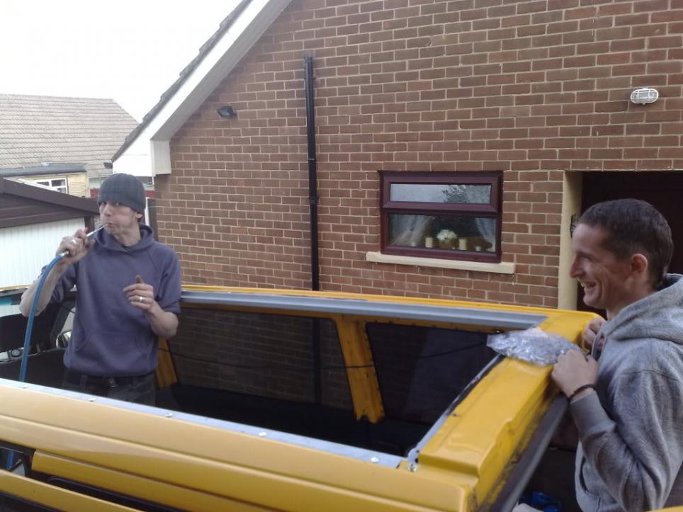

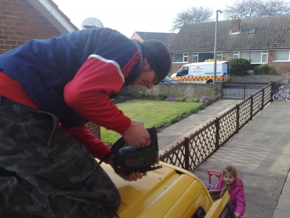

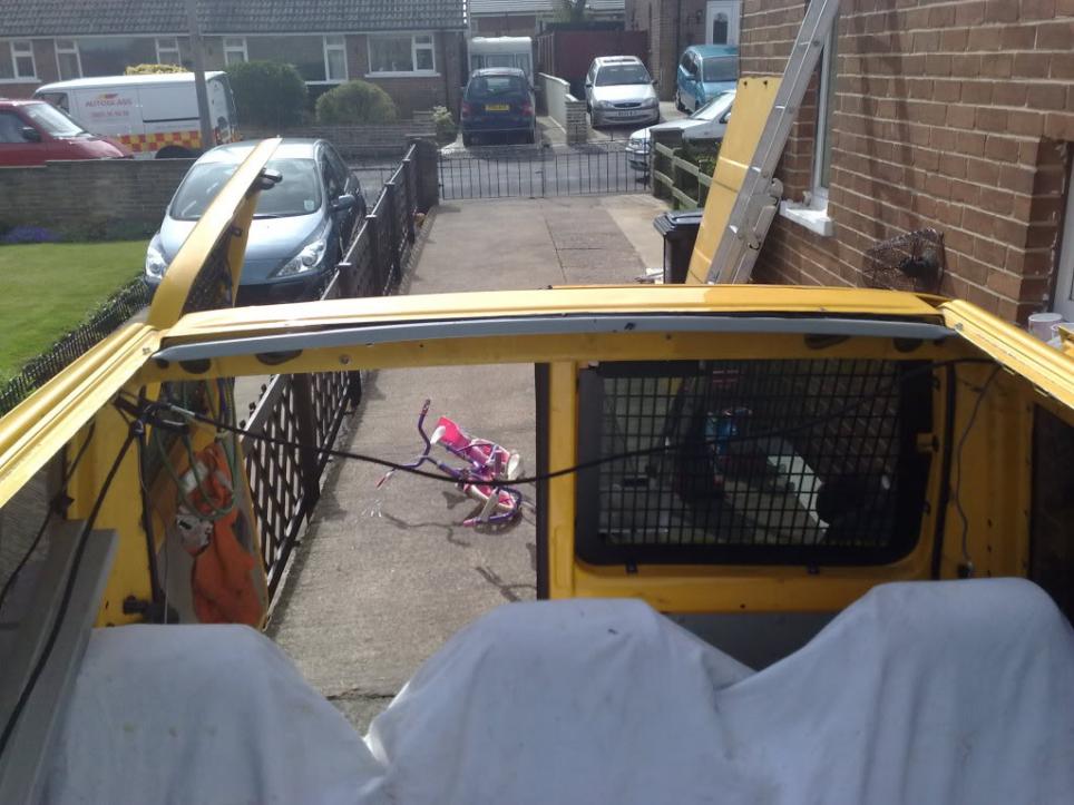

    Cut along the edges all the way round..

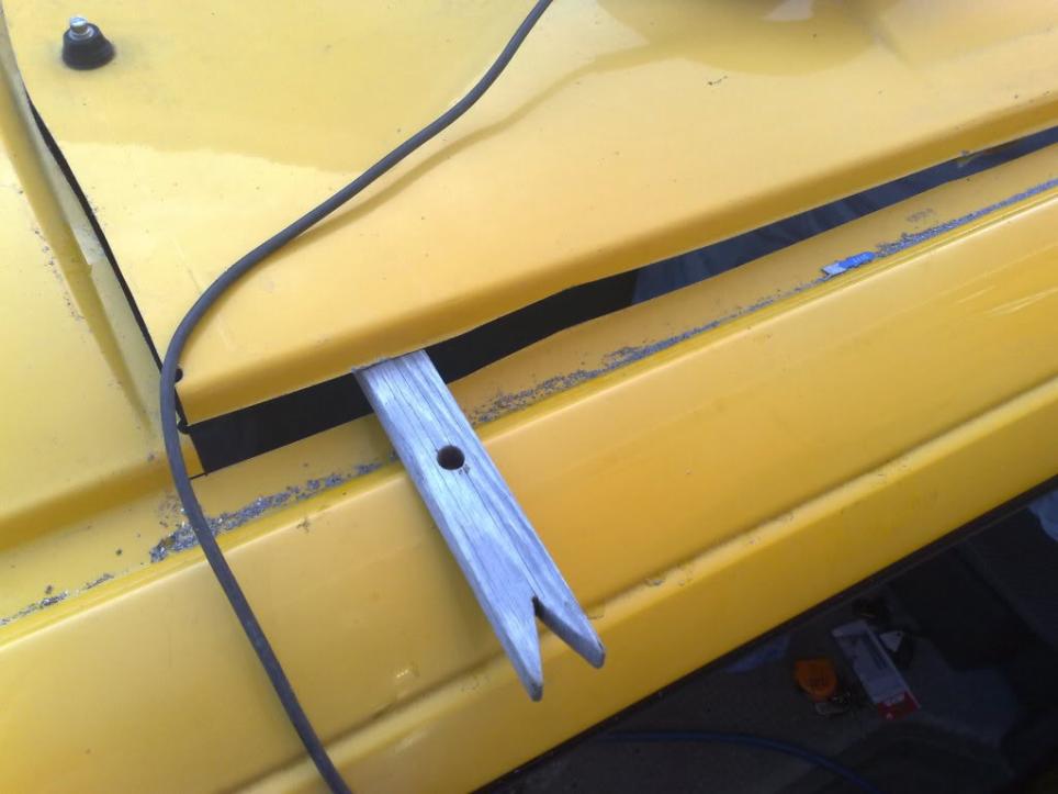

    Suport at the corners(with washing prop)

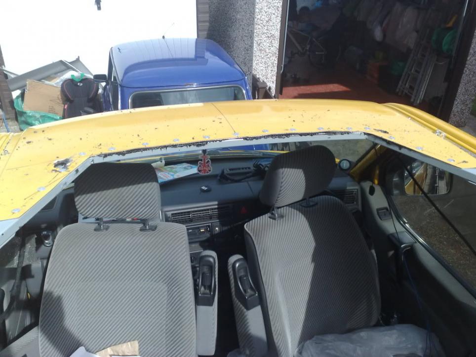

    Then remove the floppy part and line up the frame..

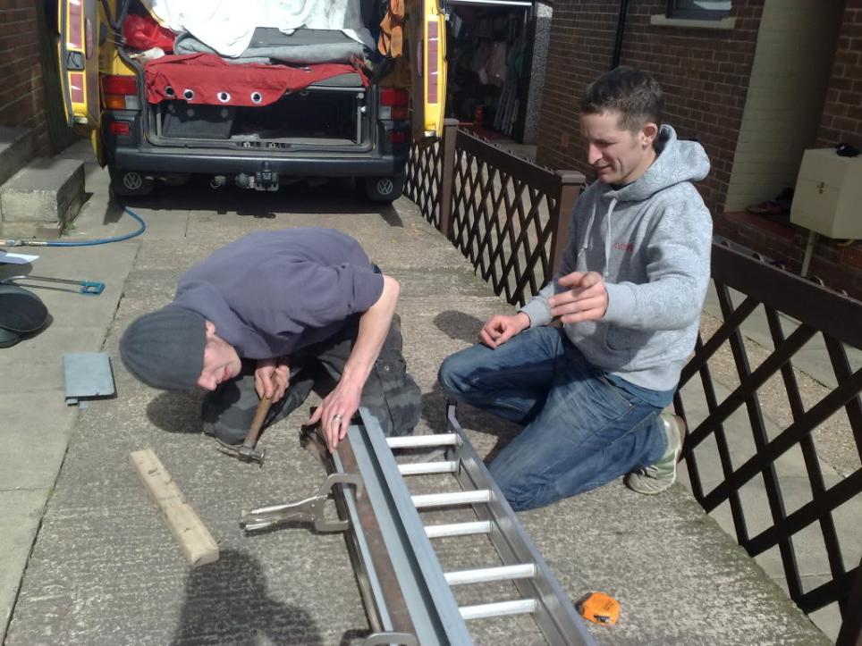

    Start to bolt the frame in(dont forget the stickaflex..

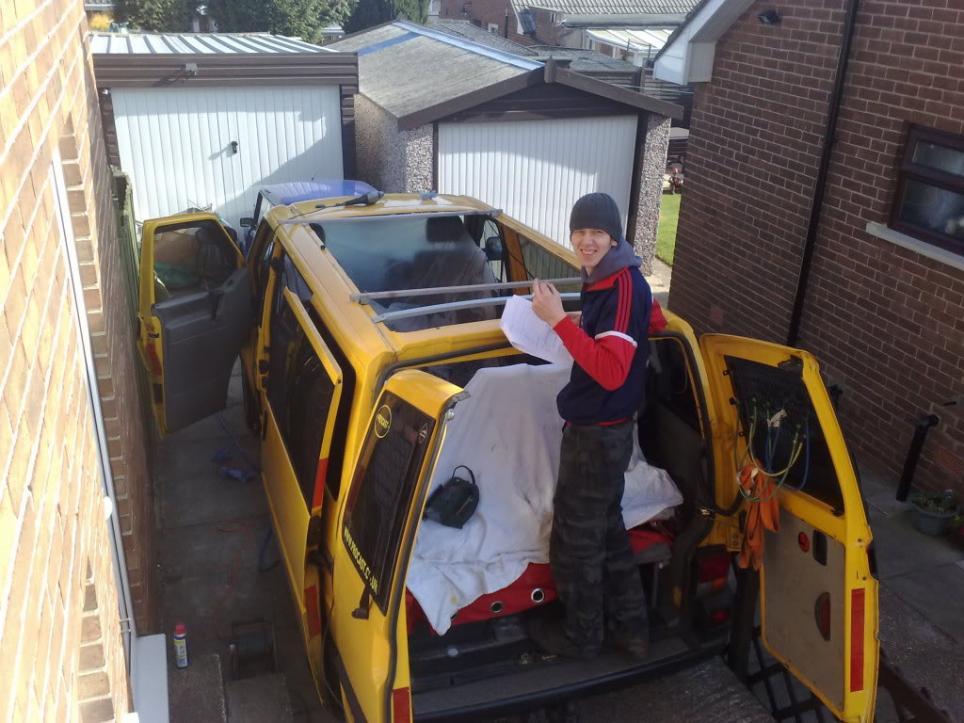

    The sides needed a little tinkering...
    Heres jim using his home made measuring stick(notherners dont have tape measures)..

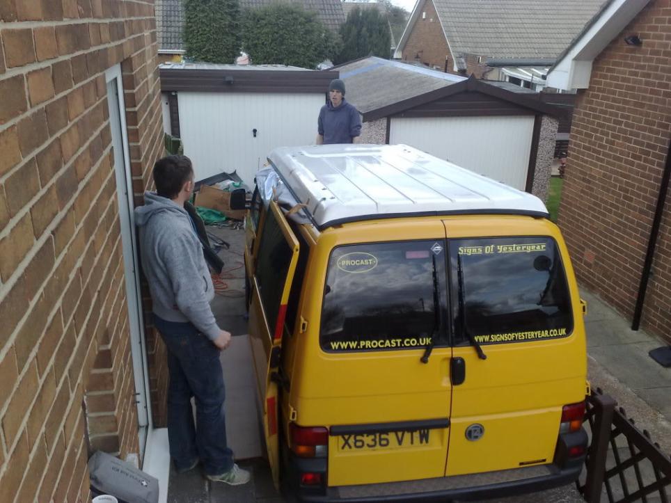

    After 7 hours the roof goes on for a trial fit and marking for hinges..
