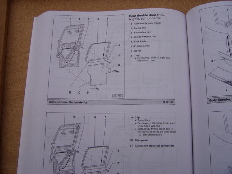

      As there are now two people who want to know I had better take a look at my manual. Will report back later.
      Not very clear, hope it is of some help.

          Hi,
          Yes, I got it off in the end. You need to pop that plastic surround on the handle off (number eight in the diagram) to one side.
