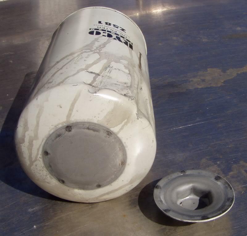

It was time for an oil change on my new[to me] T4 syncro. After draining the oil I placed a socket on the bottom of the oil filter. It was so tight that I sheared the hexagon pressing off the filter.

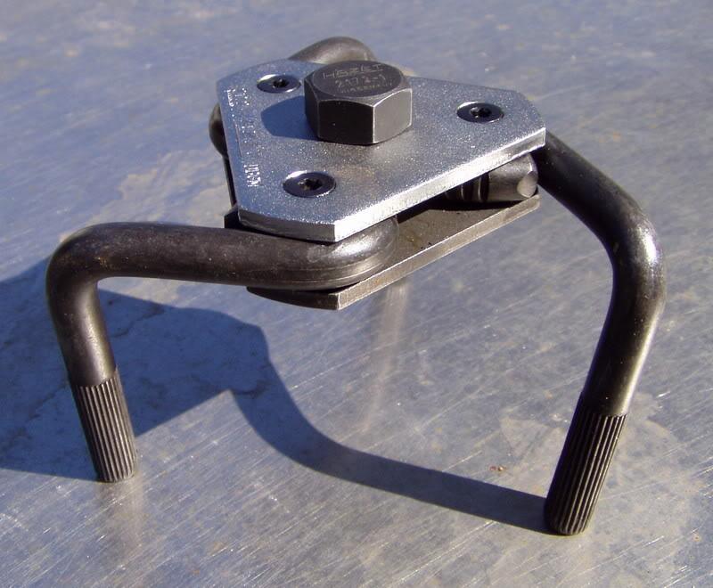

I tried to remove the rest of the oil filter with this tool but was unsuccessfull.
Normally this tool would remove any filter but the standard sliding bar needed a section of pipe to provide more force & I was limited in space. I was thinking at this stage I would need to weld a nut on the bottom but fortunately another tool I had was just able to do the job.

The tightening force for a filter is hand tight or 20Nm, not very much.
The last service was performed by a company who had written on their invoice " We take great pride in delivering the best possible service etc etc"
Now changing the oil must be one of the most basic operations in a service so what would be the result if something more involved was needed.
