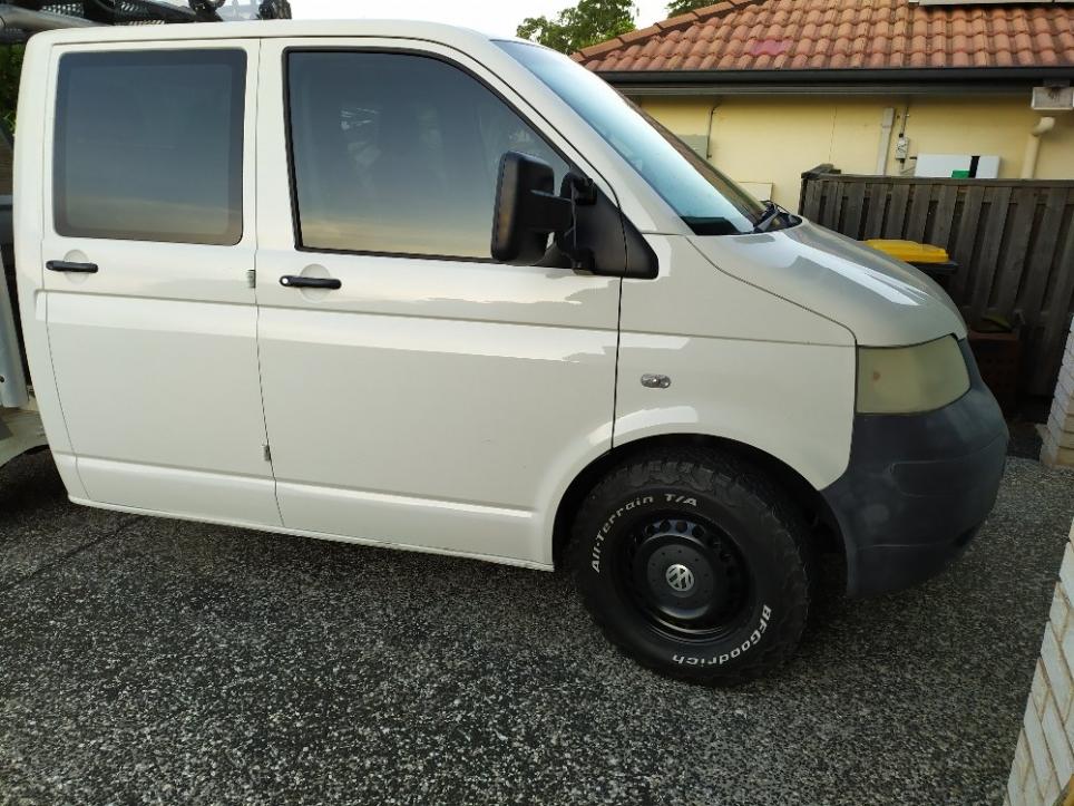

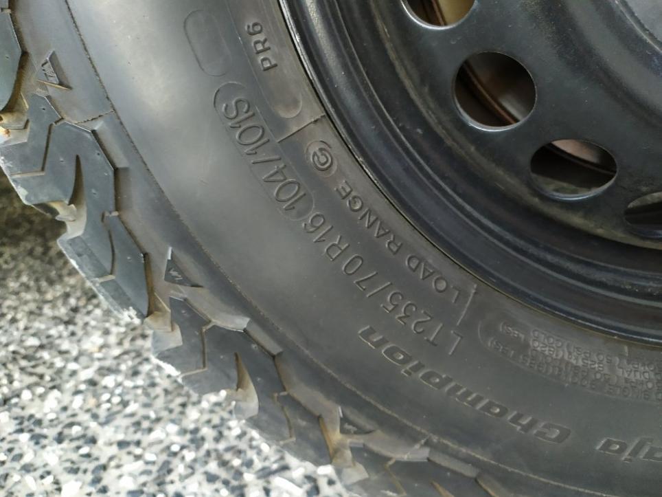

    Hi mate. I've got Amarok 16 inch steelies in 235/70R16 BF Goodrich AT's. Almost no rubbing on full lock but if the plastic inside the wheel arch is deformed at all it may rub. Speedo is a touch out, gps 100kmh vw 98kmh. Hope this helps

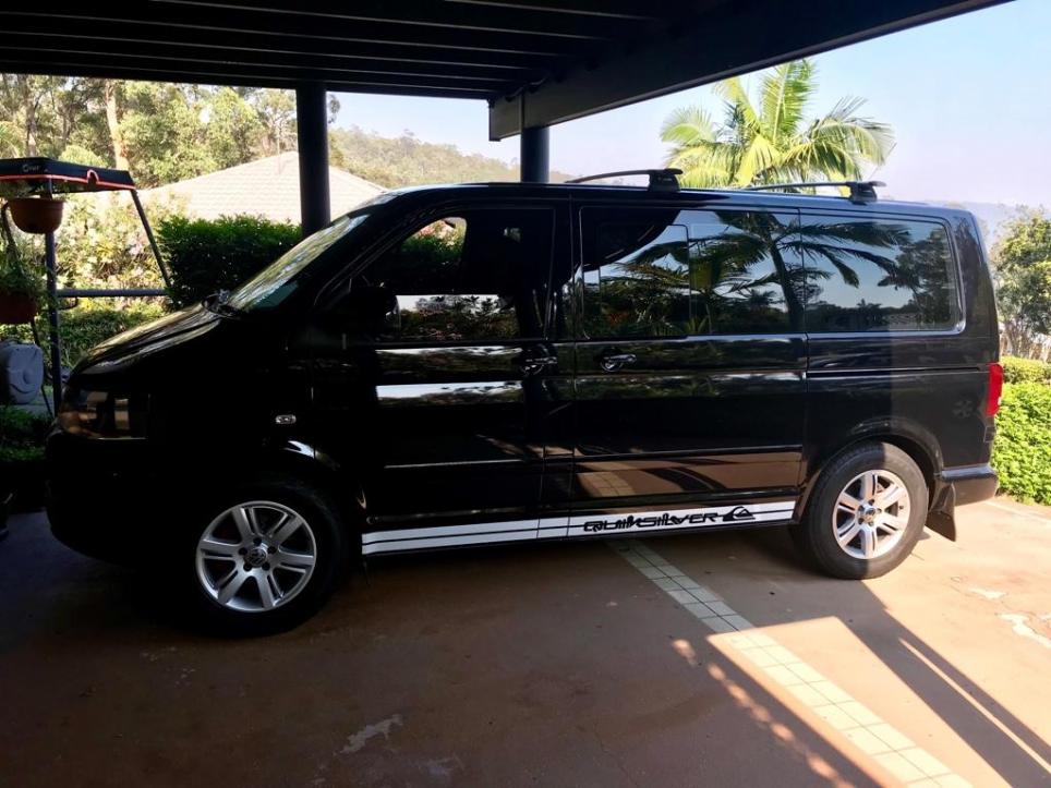

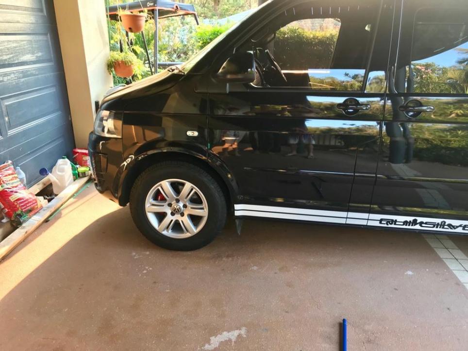

      245/65/R17. These were amarok wheels, slight rub on full lock , just trimmed the plastic a bit.
      I have adjusted speedo with VCDS cuz it was about 11kmh out.
        Hi rich543, your van looks great, well done. I have purchased the same wheels and tyres as yours and I have a few questions if you don't mind?
        1) Was the VCDS expensive, where did you buy it?
        2) Does the spare wheel fit easily?
        3) Do you know if its necessary to run the larger size brake rotors (i am upgrading from 215/65/16) or is the difference in braking performance not noticeable?

          Hey mate.
          1)I was lucky got vcds cable & small laptop all for $100[emoji106]
          2) guy I bought wheels off only had 4 , so still have original for spare. [emoji3061]
          3) I still use same size rotors just changed them for the slotted ones , seems ok.
          If your any where near Gold Coast, I’m more than happy to help you out with VCDS
          Cheers
          Riche [emoji1690][emoji1690]
