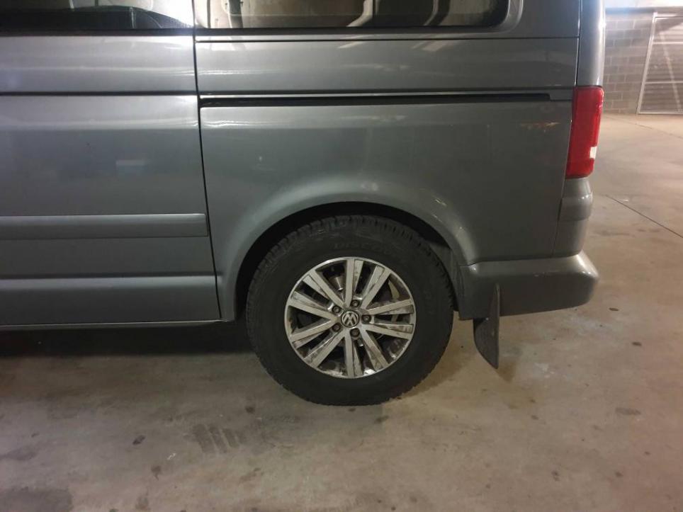

    I'll grab Pic in a moment, but I'm running standard 17s with 245/65 17 and I rub. But I have a standard height van. Saving for some king springs.

        Here you go.

            Ah thanks for the pics, they look good though, do they only rub when turning? Also what’s 49 & 54?
              Yeah. I just trimmed the front bumper where it goes into the wheel well. Number refers to the offset... How much the stick out the guard. The lower the number the more they stick out. There are some rims for 400, but they're et 25.. A bit too aggressive. Maybe after the springs go in.

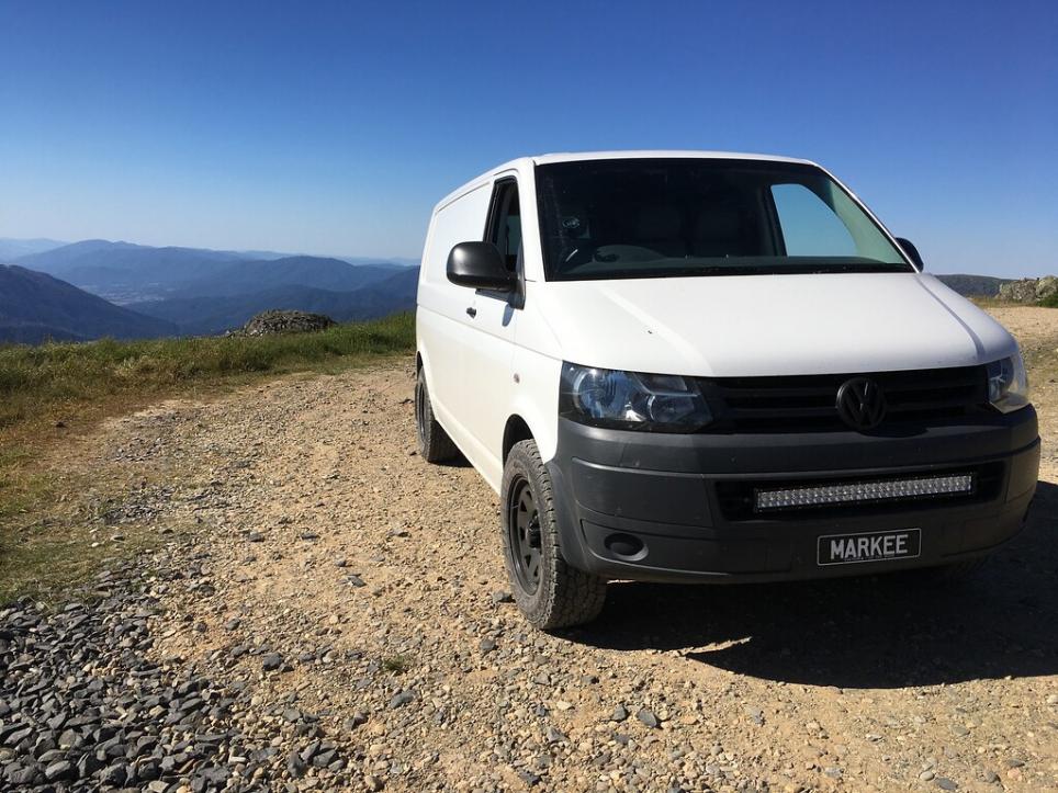

                    I use 245/65x17 on 17x7.5in ET35 rims and they only just touch on full lock. I do have raised King Springs though. Fills the guards nicely.

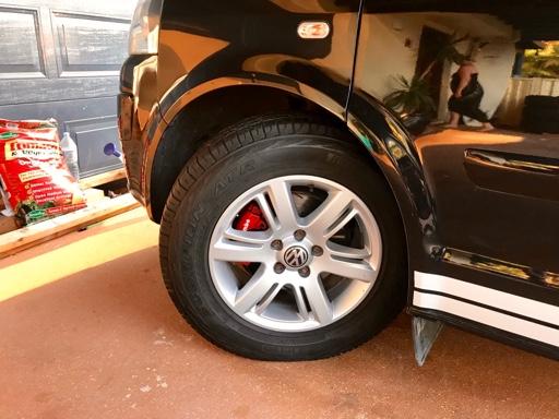

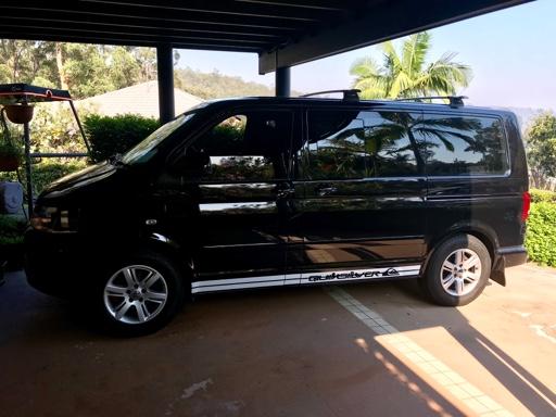

                      Got my 245,s on , they only seem to rub slightly on full lock, haven’t tried with a full load of people yet though, bargain though $275 4 wheels & tyres[emoji1690][emoji1690]. Heaps of tread[emoji6][emoji106][emoji106]
