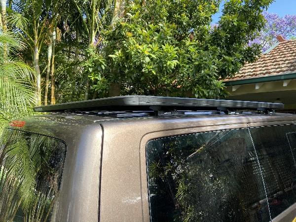

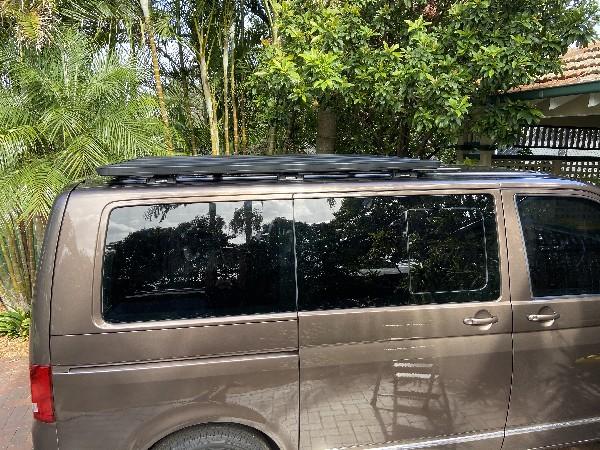

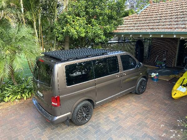

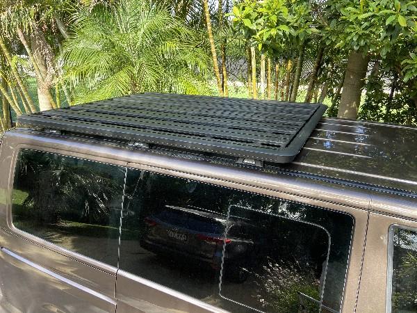

Well my pioneer platform arrived today, went for the 1828 x 1426 size and I will be fitting it to the factory tracks of my T5 with the RLTPMV feet. The RLTPMV come with plastic wedges which helps level them up on the van. Little bit of modding will be required with some shims and the bolts need 5mm off them as the factory tracks are shallower than the rhino tracks but it will work. I will post some pictures when finished.
Well got the platform on today with no real issues. As its so low tightening the bolts up is time consuming but it does mean nobody is going to be to whip it off easily. Love the low stance and the size is perfect for what I wanted leaving the front roof section uncovered. Hope the image links work as never done this before.
