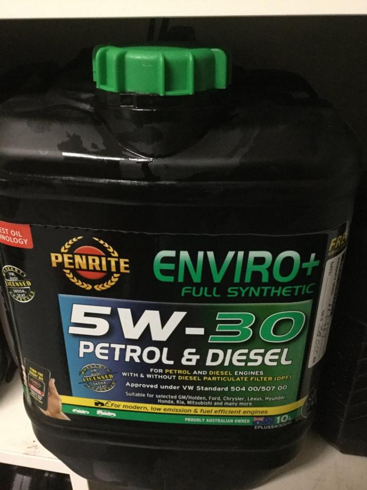

    Is Penrite Enviro+ C3 5-30w okay to use?

        This is the oil used from Repco .Used Ryco Z435. First oil change on this type of VW. Straight forward. Did not use crush washer , but normally do. Just get a few next time. No leaks. Used about 7 litres of oil .

            Need VW spec 507.01
              The Z435 is definitely wrong filter. As other suggested use genuine filter only and I’d be voiding eBay filters since they’re unknown quality. The risk is just not worth it.
