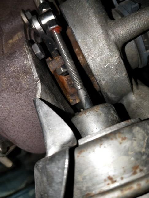

1.Vacuum actuator hooked in to VNT actuator lever, photo taken from top side, bubbles seen on startup.

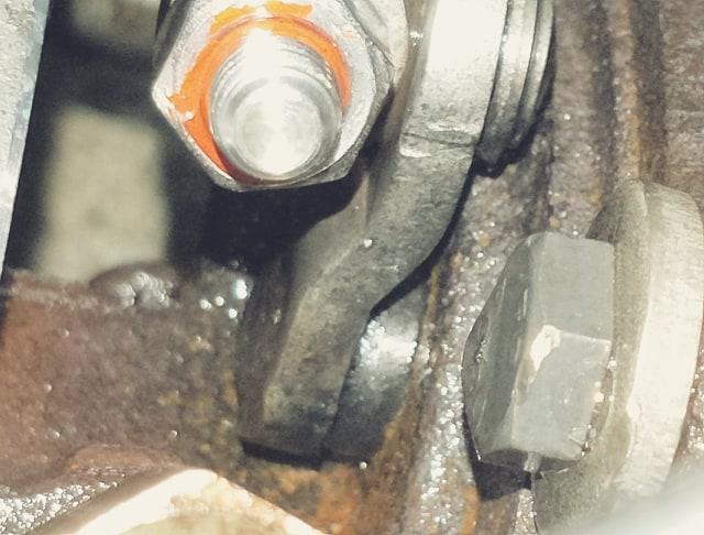

2.Zoomed in photo of actuator arm as it connects to VNT actuator shaft, from top side.

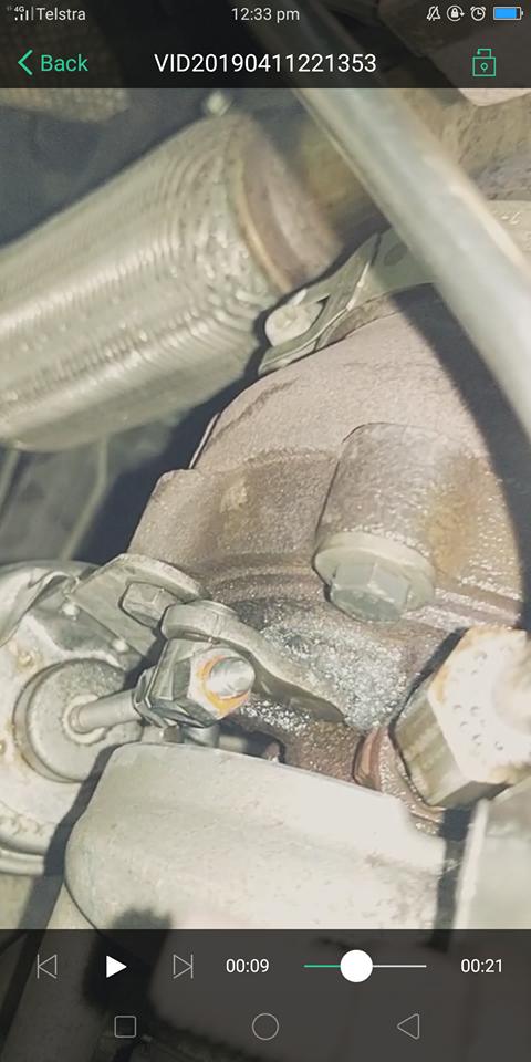

3.Taken from underneath, VNT actuator lever, telltaletraces of soot indicating leak.

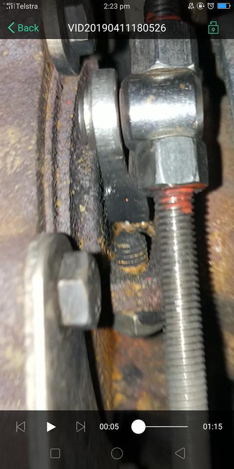

4.Zoomed out photo from underneath, for perspective,of actuator shaft. Noted this area of the turbo is quite rusty compared to theother parts.
