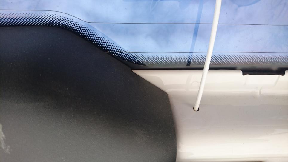

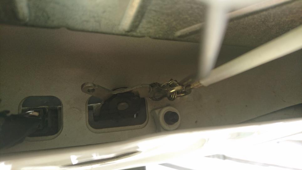

            I also have drawers with a bed on top and like to open the tail gate from inside.
            I used a bit of curtain wire attached to the manual mechanism which runs up to a small hole I drilled next to the brake light.
            Works good just pulling on the wire although the plan for the finishing touch is to find a cool figurine to stick on top.
