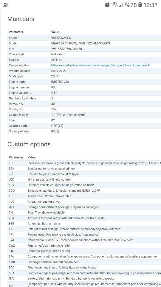

    Hi Lance;
    Crafter 35 LWB = Crafter Long Wheel Base 3.5 Ton Weight Single Tire
    Crafter 50 LWB = Crafter Long Wheel Base 5 Ton Wheight Dual Tire
    Best Regrads.
    SM-G610F cihazımdan Tapatalk kullanılarak gönderildi
      Hi Lance;
      Your Vans information.
      2nd part is written in 1 th line.
        Great, thanks for that my friend.
        I guess that was buried somewhere in my VIN that I missed.
        Thanks again
